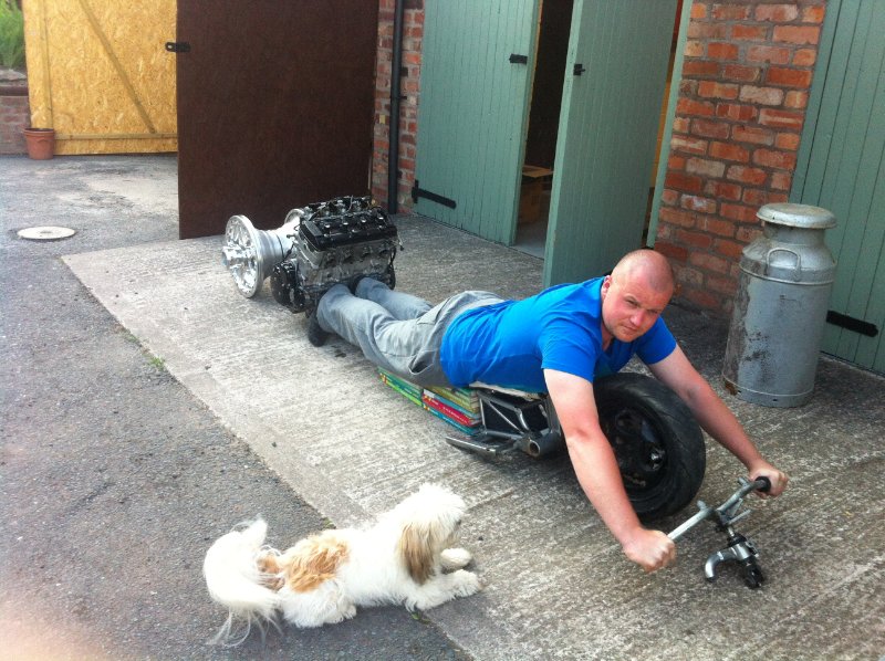

Its not a mopar and i hope its ok to use the mma as a platform for this build.
Ever since someone on this forum posted up a picture of a 1980s drag bike i have been fixed. And feel its my calling to run this
Yes i know i should finish other projects first ;) but might be to sensible to ride this then.

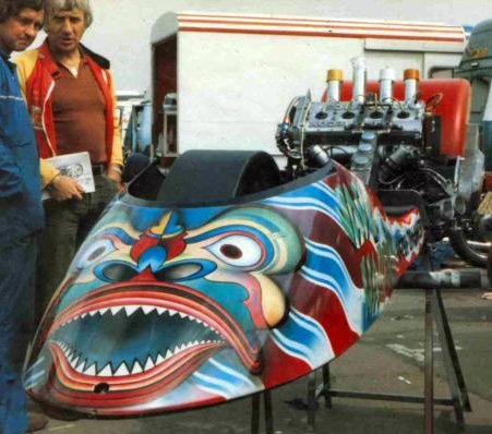

So in 1980 a man called Angus Mcphail built and race a drag bike called Jade warrior it went sub 8sec
Im in talks with Angus and he is pleased someone is trying again.
The orginal bike was made of alu and the fuel has corroded it badly also it used a 1970s F1 rear wheel and tyre 13x17 You just cant get a Tyre this wide any more . so a new bike with new parts will be built.
Bodywork work we made from the original Jade warrior molds

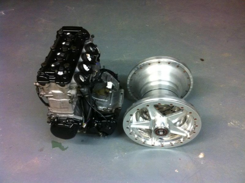

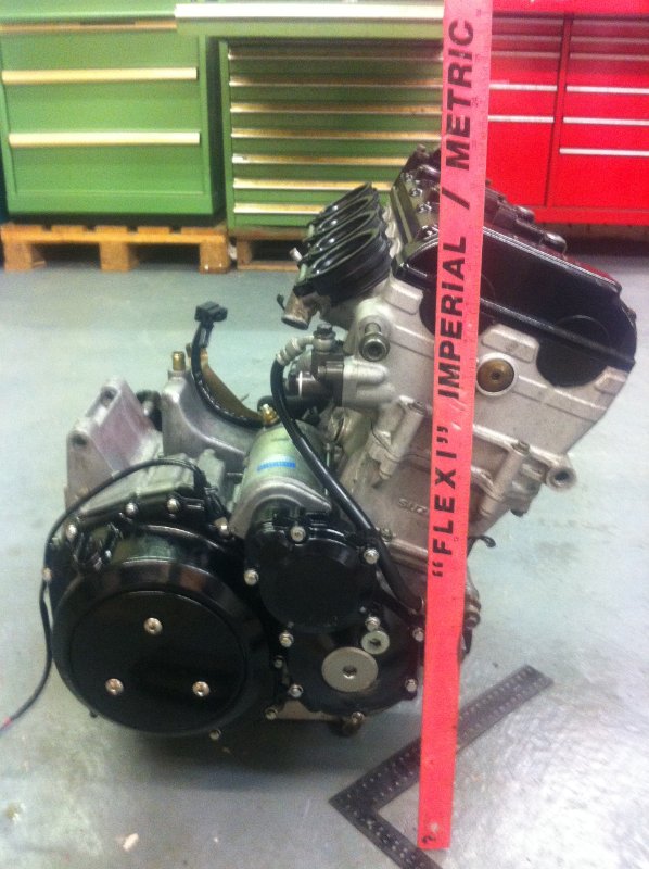

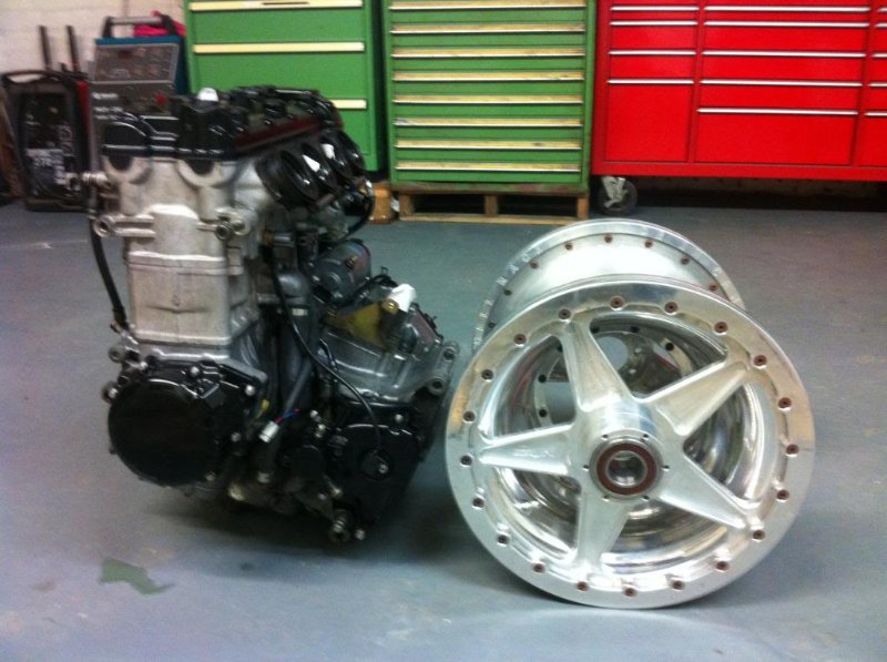

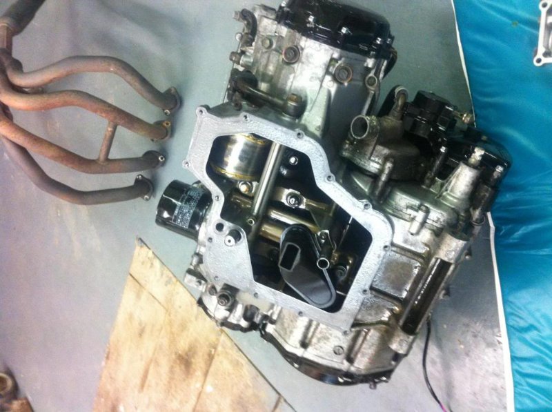

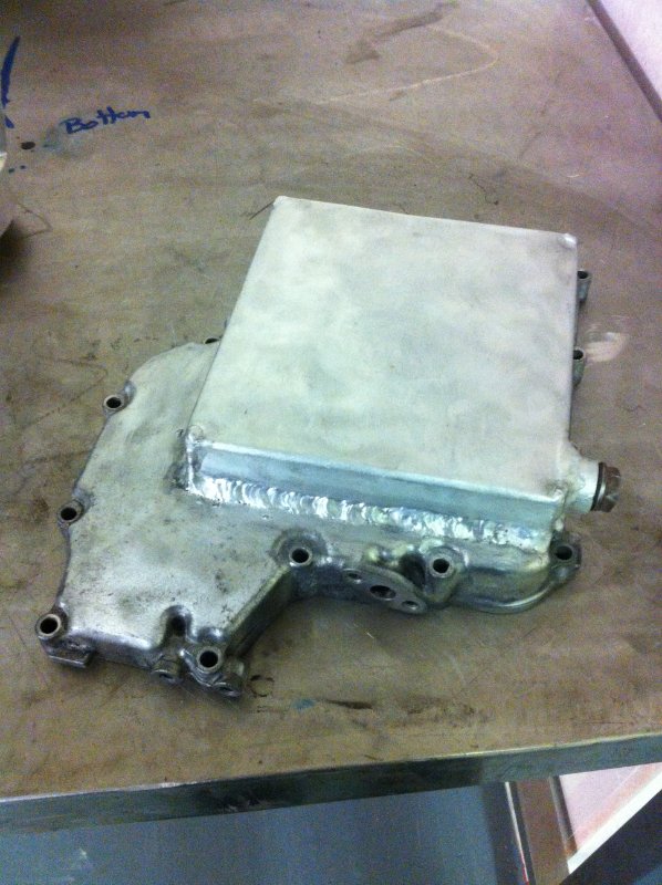

Wheel is a custom made 15x14 top fuel drag bike rear wheel.

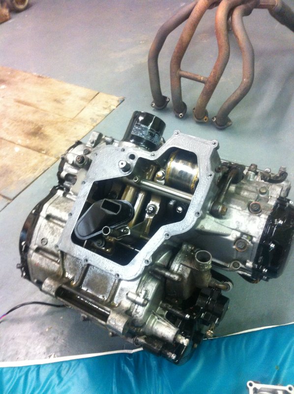

Engine Chrysler Hayabusa 1300cc 187bhp Bike engine

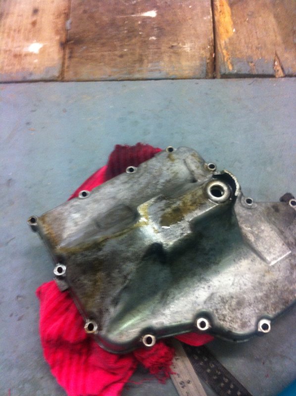

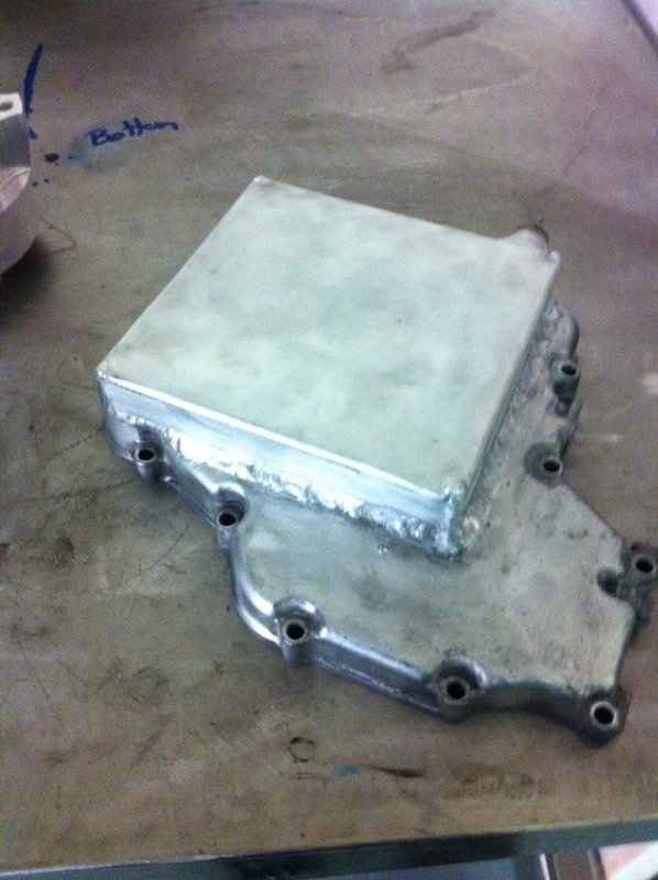

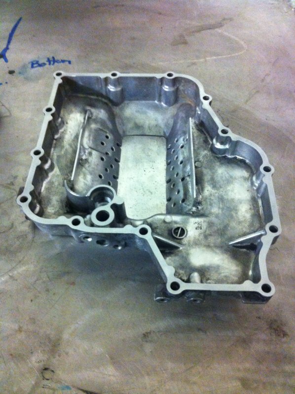

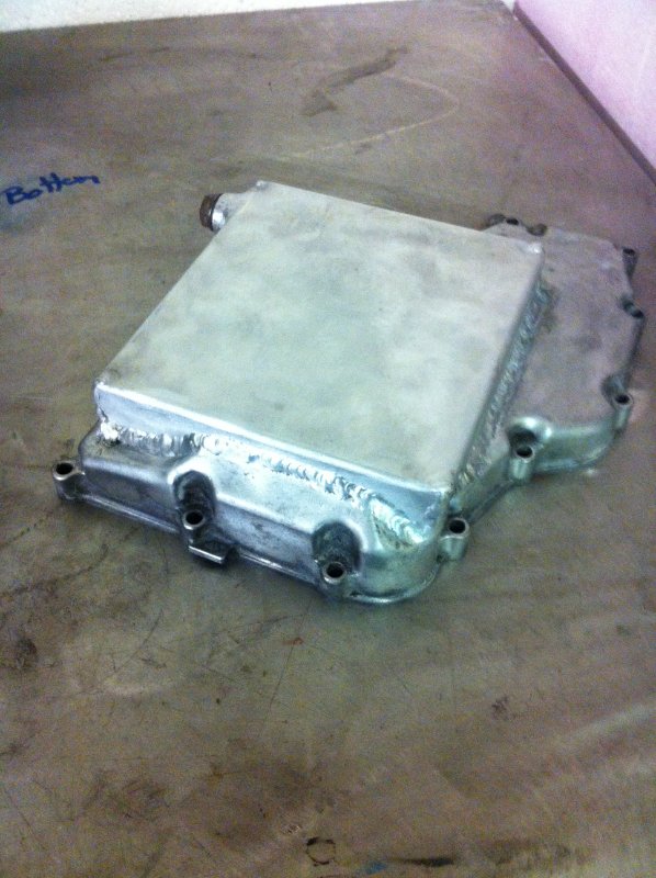

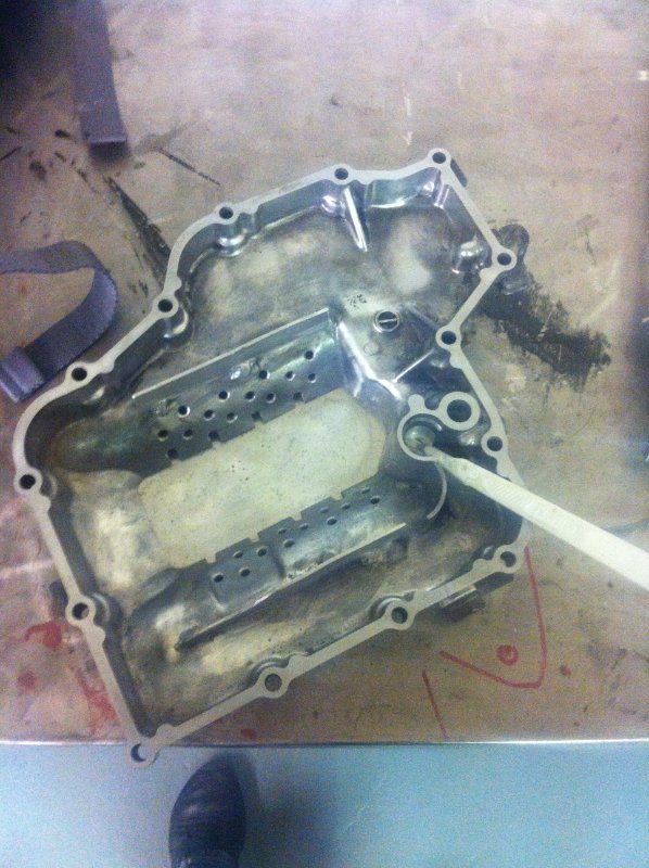

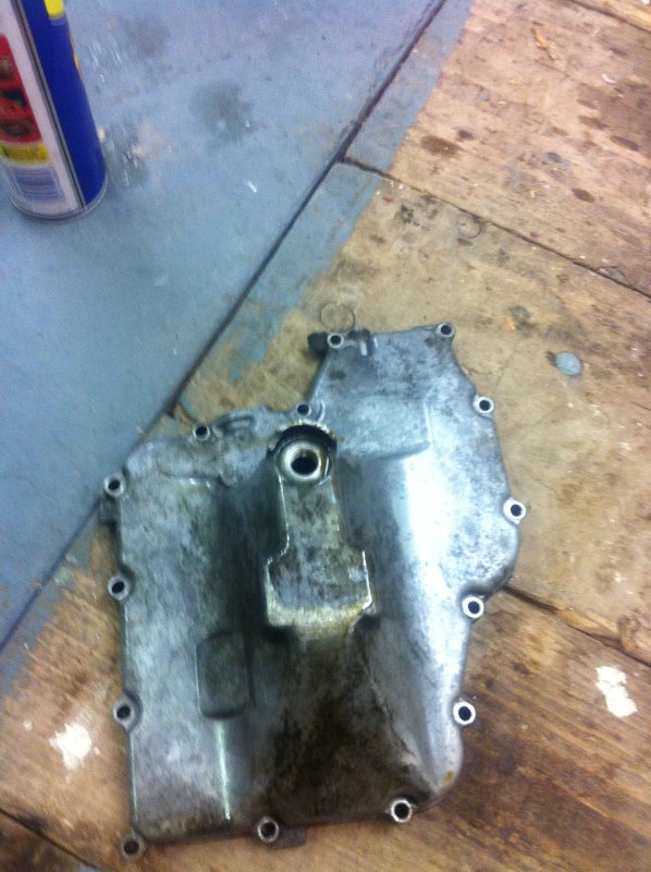

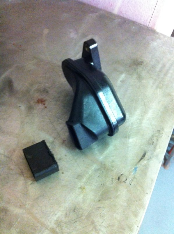

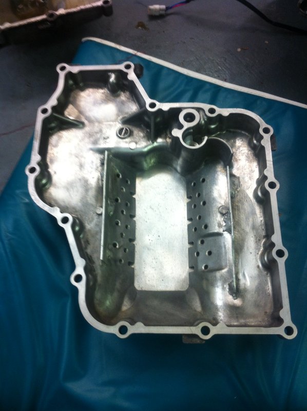

First issue is bike sump is a deep V so made up a new flat sump. This will also help for mock up as the engine now sits at the correct angle.

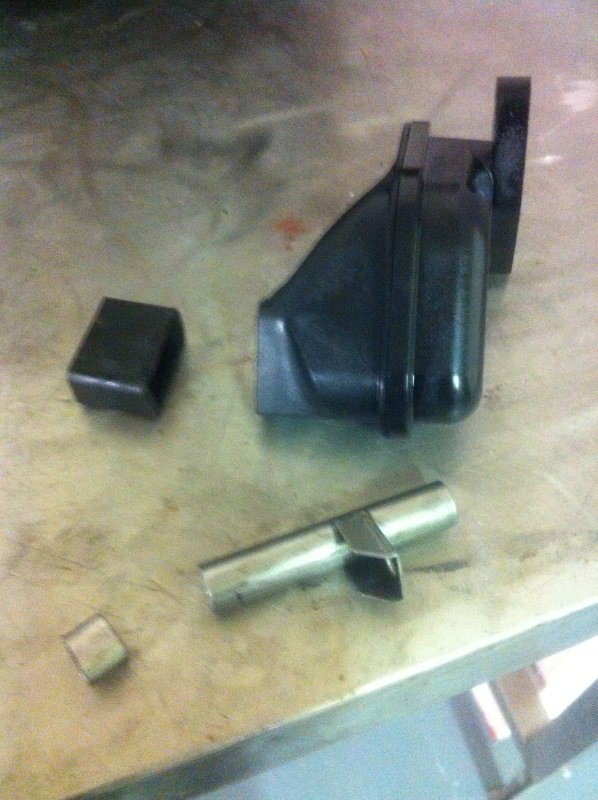

After welding the sump was machine flat and pick up and return where also shortened.
The sump may be shorter but oil capacity is up 0.9l
