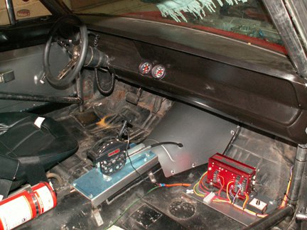

Ran an 7al3 on the old bus ,never missed a beat .Had some options wired up ..second hand power coil from Mark , never let me down,,,,I would run one again ,if i could afford one now
- 181568_179029442139253_5838235_n.jpg (41.68 KiB) Viewed 1437 times
