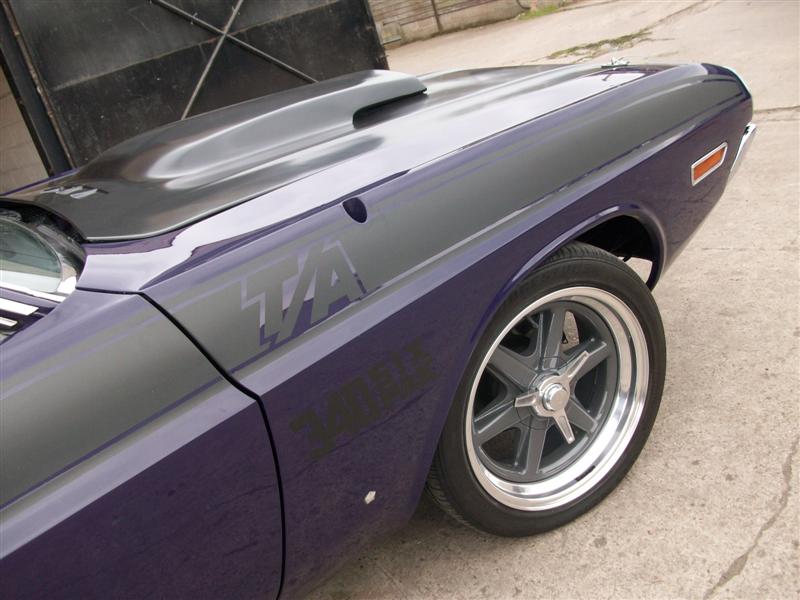

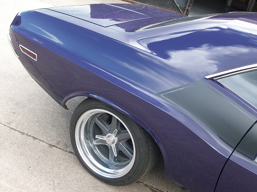

Col .........here are a set of 17" and 18" on a Chally i had ....... ;)
Not all approve but I like the look ......... ;)
Sorry Ade ...... ;)
70 CHALLENGER 340 SIX PACK TA 033.jpg (140.87 KiB) Viewed 1794 times

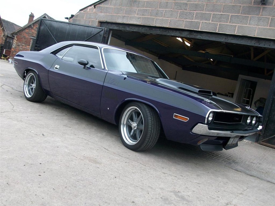

BUDGIE
Post by BUDGIE »
TBH the rear tyre was a little to narrow ......... :oops:
70 CHALLENGER 340 SIX PACK TA 006 (Large).jpg (206.1 KiB) Viewed 1789 times

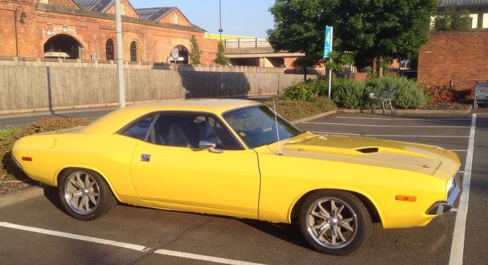

Yeah I remember that one shag, see it at the yard just after graphics and wheels went on, nice car :thumbright:
Here's my poor effort ;)

BUDGIE wrote:TBH the rear tyre was a little to narrow ......... :oops:
I can see what you mean but the general look of those wheels looks good to me... Do you recall the width of the rear rim and that tyre?
BUDGIE
Post by BUDGIE »
T'was a 9.5" ..........the rubber from memory was a 275 x 40 x 18 :scratch:
