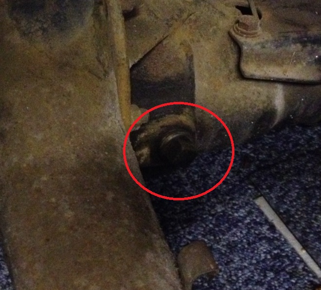

This thing. Is it the drain plug ? Siphon tube needed to empty, pump clean stuff back in ?
Daft question I know, but I've read they don't always have one.

Yep,
It`s actually known as a level plug ;)

Thanks chaps. Level plug it is... (As in 'fill up to this level')
Posts: 22138
Wot John said!
Or you can pull the half shafts, Prop, and drop all 85lbs Plus of pig out and spill stinking EP80/90 everywhere and put new in!!!!
...or you can take the easy option and check / top up!

Don't forget the additive for suregrip if using ordinary EP 80/90.

Personally I would strip out the half shafts and diff to leave a bare case to sandblast and powdercoat. Not hard to do at all and you can fit a new diff gasket while you are at it. You can't make a decent job of cleaning and painting the axle with it fully assembled IMO.

Apart from setting the end float on the half shafts when reassembling (which is dead simple) it really is just nuts and bolts. The voodoo is located inside the diff itself and there is no need to mess with that.
