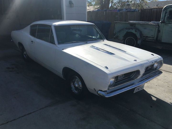

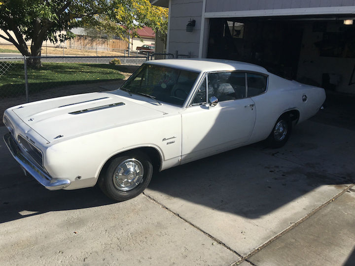

So that's the background, in early November I spotted one on eBay as a buy it now and apart from being a bit scuffier than I ideally wanted, it fitted the brief. Problem was it was suspiciously cheap, a zero feedback seller who I rapidly deduced was almost certainly Mexican, it didn't inspire confidence.
So I watched it and continued searching. Then after a few weeks he dropped the price, I still couldn't make my mind up and then a day before the auction ended I thought what the hell and hit the button. At this point I hadn't spoken to or even contacted the seller, not what I'd recommend at all.
As it happened, when I called him the Mexican guy was happy enough to deal with me and sent me copies of the documents and was no problem to deal with at all. So, fast forward to Christmas Eve when Don kindly picked it up from Southampton for me I got to see what I'd actually bought, even though it had come out of Nevada, serious rust was my big worry. It was pretty much as described, no better no worse, phew!

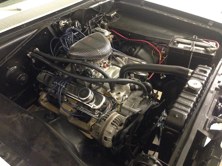

Apart from a recently dropped in 360 the car is stock. it has a few knocks and dings and some minor rust at the bottom of one rear quarter, I've yet to find any other rust. It has the worlds worst driveway paint job which I don't think is hiding anything. The interior is tired original, with fabric inserts added and some time I think, dash is complete and not hacked up though someone thought the best way to dress up the faded plastic chrome would be to paint it all black...

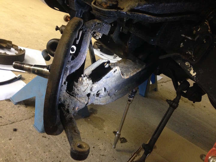

I'm now on with sorting a few jobs for the MOT, I was fooling myself that It wouldn't need much, when I said stock I mean almost certainly never touched, every bush, balljoint and track rod end was totally shot, every wheel cyl weeping, no great surprise or problem the whole front suspension is off and stripped all the parts are on their way. The upper A arm bushes were that bad the inner sleeves had seized to the cams, and had to be cut out, never had to do that before, horrible job!
