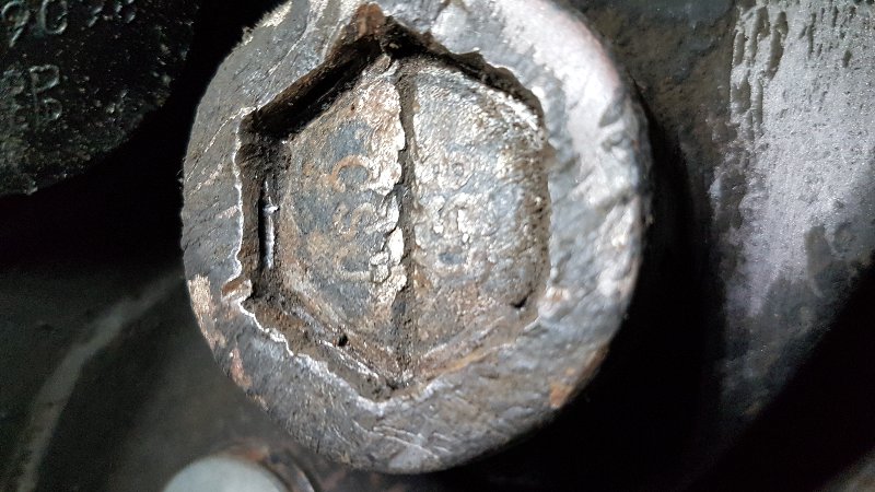

So, I've read about as much as I can find online about refurbishing the front suspension and made a start yesterday.
Everything was coming apart nicely until I got to the torsion bar. It doesn't appear to have the circlip in the rear mount. The pic shows the rear mount. Is this where the clip should be? Is so, and it is missing, what's holding it in?
Posts: 22176
Re: Front end rebuild question
It is being held in with the load on it imparted by the Control Arm.
In reality you need a Torsion bar removal tool to do it properly, but if you are lucky you can use a pry bar on the Lower control arm to get things moving.
If you look carefully you will see there is a groove for the Circlip at the back of the housing on the Gearbox Cross member.

Thanks Pete, I did think the grooves were for the clip. The mount looks a bit battered, hopefully they've not peened it over to hold the bar in.
Looks like more shopping for me then! :roll:

I found a tip when I was doing mine where you take a bit of weight off the k member with a trolley jack and it takes almost all the tension out of the torsion bar.
Mine then came out with a few taps on the end with a piece of wood.
Just don't use mole grips on them and a hammer!
Posts: 4266
Yup. Circlip missing - but it aint going anywhere.
I got mine out by making a long clamp which held about 8" of the bar without marking it. Take the weight of the arm so nothing is in torsion, quick tap and it pops right out. Its not as scary as it seems - 10 min job if you get lucky :)

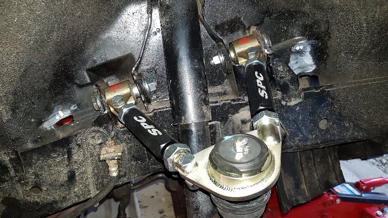

YAY!!
Thanks to all you help and advice, and a little persuasion from 'The Persuader', one side is mostly done.
New UCA is in, LCA is undergoing a rebuild.

Lovely refurbished lca with new pivot pin and bush, ready to go in.
