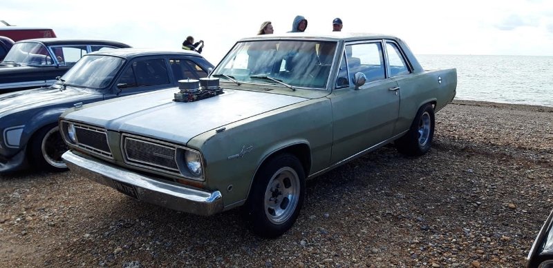

so i've looked for a blasphemers section but can't find one so here it is :angel12: . as above some of you may have seen the green valiant on ebay over the last few months down in bristol. so it's now here with me. initially i planned to fit a jensen 383/727 a mate has offered me which he took out of his ford pilot to fit a 302 ford (more economy). but over a year ago i started collecting parts to build a 383 chevy stroker motor with lowish compression so it could be turboed. so i'm going to fit this along with a 5 speed manual box to the valiant along with a 9" ford rear axle as the little A body axle wouldn't like the 700 ish hp the motor will make. other than the drivetrain bast...isation it'll be gloss black with black interior (not sure whether to retrim the benches or just go with s/hand 'modern' leather seats).
so give it to me guys, should i continue to keep you updated as and when or is this too far from what's expected behaviour on here?
regards, neil.

for this summer the plan is to get it moted so i can register it as is and get it on historic tax. dvla won't register 'modified' imports these days on historic tax class full stop, not happening. hence register and tax it as stock then swap out the parts while still staying within the 8 points rule. i've bought turbos now too, a pair of to4e's at £100 each which is a bargain. i know they're chinese but i've been on the turbo forums for a while asking advise and checking prospective purchases so it's got as good a chance of being ok as any other build i guess. so the engine will be put together this summer and it'll all get swapped in over the winter. at this stage i wasn't going to fit an intercooler as it'll only be running about 7psi of boost which is well within the turbos capability so shouldn't make too much heat, i'll have to suck it and see. i work at rally design so hoses, pipes and intercoolers are cheap to me so if it needs one/two it's not a problem.
i'll hopefully at least get a set of wheels on it for this summer, the 13's don't do the looks any favours for sure.
i'll update when i do more but it'll be slow as i've got a corsair in for a v6 swap at the moment followed by a mk2 zephyr with a 283 chevy for a few jobs and then build the 350 chevy to refit to my boys mk3 zephyr hirider. busy, busy :roll:
cheers, neil.
