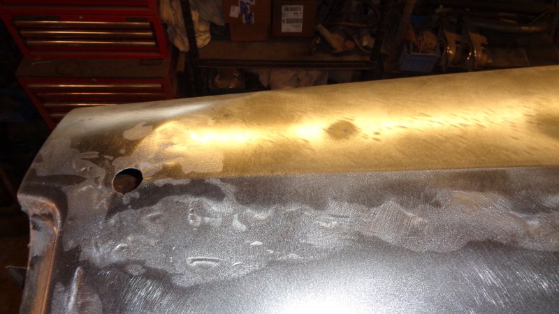

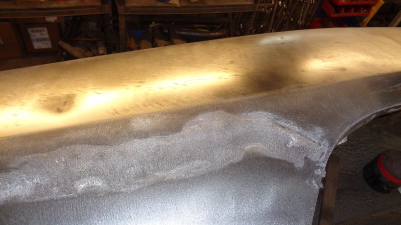

front window frame looked bad at first but after a good clean with the wire brush just a couple of pin holes in the top corner, easy repair with a bit of lead
well on the way stripping back to bare metal waiting for the rotisserie jig , second best bit of kit we have got ,makes it so much easier to clean the under side and cut out the quarters and weld in the new repair panels ,grind back and lead fill just a tiny bit of filler required to finish off

the rear quarters in place, lead filled and with a thin coat of filler
