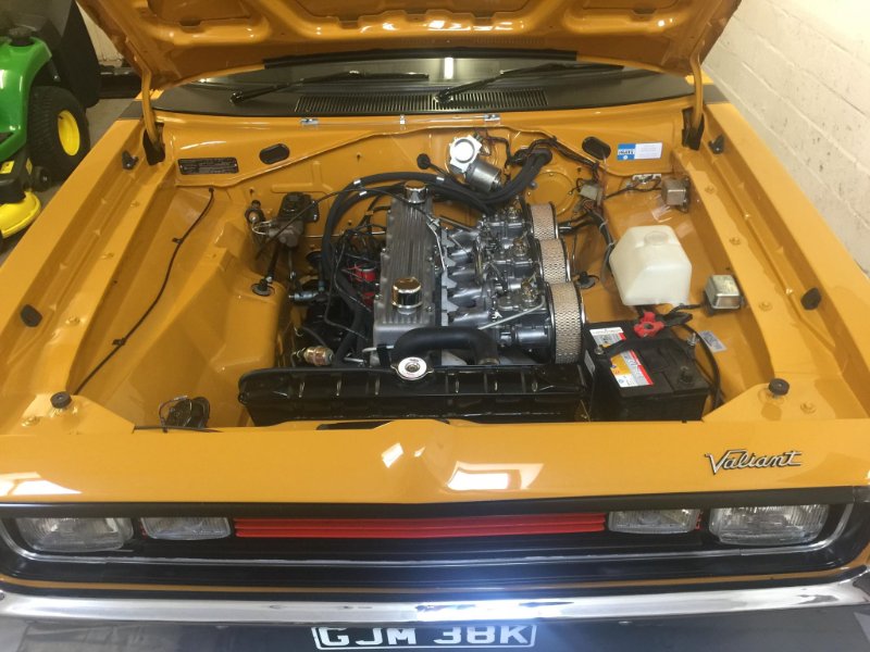

What was the hemi in the breakers out of?
- 101682775_1085426785166070_153128846961410048_n.jpg (91.8 KiB) Viewed 2895 times

I didn't realise John had them over here, I thought they lived in NZ.
