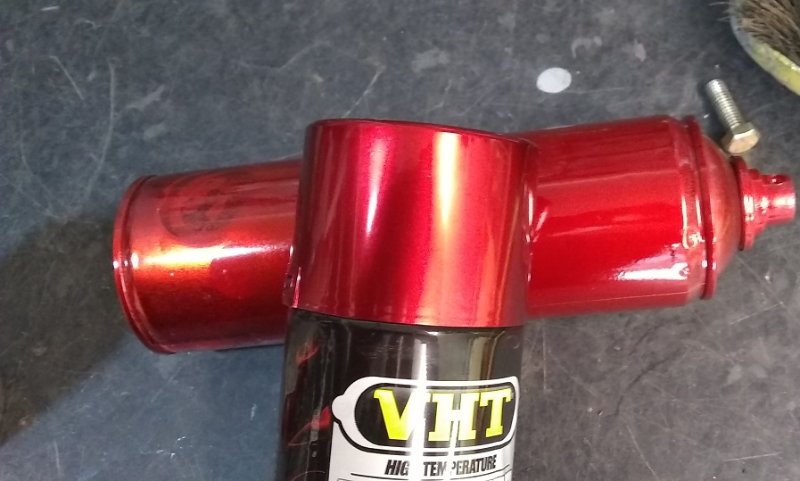

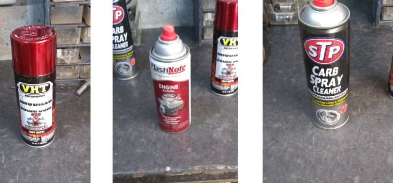

Right I was expecting it to come out mat, nope came out quite shiny.
Anyhow here's my little experiment, using the STP can to try it on, first Silver plasti koat first then the red.
The problem is it come out way too heavy and thick, so it just looks like shiny red paint and not like the can top.
So I have a cunning plan. ;)

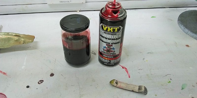

Ive have let all the gas out of the VHT spray can and I am going take the paint out and to apply it with the spray gun, once thinned down.
I've already do a test by squirting some in the cap and thinning it with a good result and no reacting.
I can then control the thinness and the speed :thumbright:

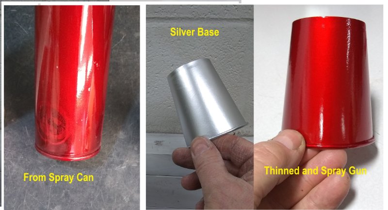

Well you get a lot better controle once thinned and use a spray gun,used the same engine silver,
But thined the red by 70/ 30
Posts: 6747
Re: VHT Red Anodised spray paint, anyone tried it?
Test piece turned out OK :thumbright:

mopar_mark wrote: Wed Feb 10, 21 6:34 pm Test piece turned out OK :thumbright:
Yes, I do like the finnish now
