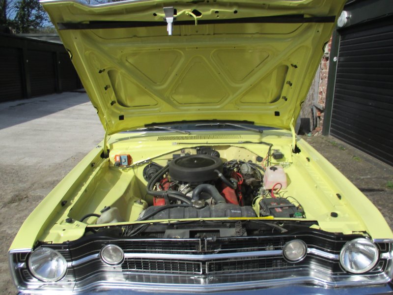

Hi guys, hope you can help, mopar electrics having a mind of their own. When ignition on all indicators work except the passenger side front. It stays solid orange. On dipped exactly the same. On main beam both smaller running lights go out (these are the indicators) and same on full beam. Worked fine before. bulb looks fine, i have others but can't find them. Did try a white double filament but no change. I'll take a video tomorrow but may be too bid to upload. Dave 999, i know you will go into too much detail that my brain can't comput. Keep it short sir :thumbright: !
