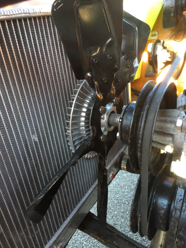

You need a cooler stat, 180 to 185 is the ideal temp. I prefer the high flow Mr Gasket ones. I like to use a coolent recovery tank to ensure the radiator is free of air. What fan do you have and what’s your initial timing set at?

Viscous fan, can’t remember if timing was 4 or 6 before tdc
Pic of fan below. Will check out coolant recovery tanks. :-k

Ok, you need more initial timing that's not enough for modern pump swill, that's one reason for it running hot.
