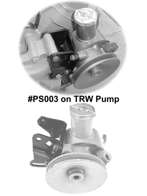

Re: Power Steering Pump Compatability
This is what I have on my 68 383...

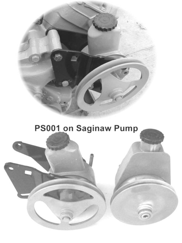

My pulley was buckled but put one of these on....
