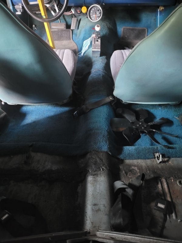

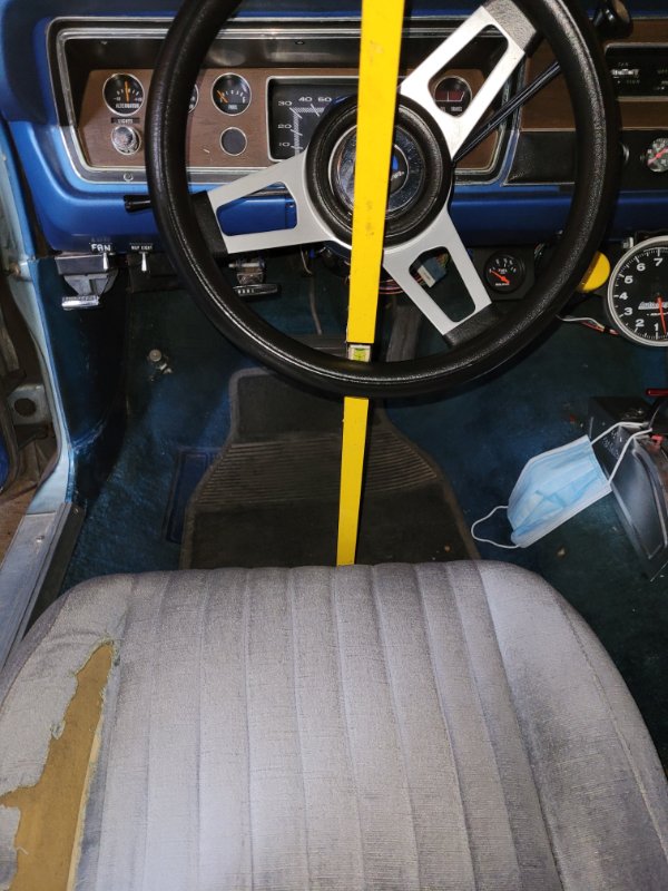

Well after putting both sides in I could instantly see a difference between the drivers and passengers side. The passengers side went in perfect utilising the original being seat outer slots.
The drivers was done using the same process, but it is obviously a few inches closer to the door. Basically I am off center to the steering wheel. You can also see it wen looking at the trans tunnel. The drivers seat is a lot further away from it.
Has anybody come up against this before?
It was confirmed by a quick drive around the area.

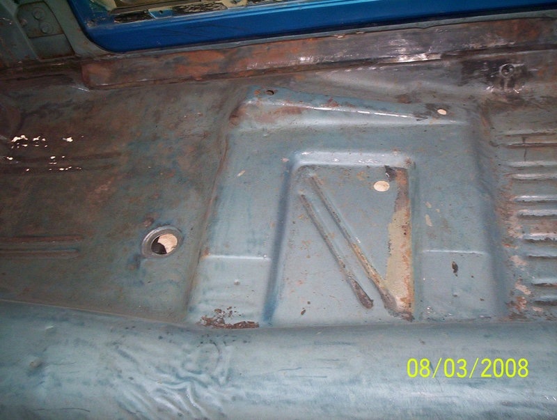

If I remember correctly, the mounting points for bucket seats are dimpled into the floor pan but not drilled through. The outer holes fall within the reinforced area but the inners don't and need a flat plate tacking in. My Barracuda was originally a bench seat car that I fitted with factory buckets and everything lines up nicely.

When I'm next out at the car I will take some internal pics and you can see...
Re: Bench to Buckets.....
You can see here where the inner holes are dimpled, a bucket seat car would have square plates welded onto those flat recessed areas.

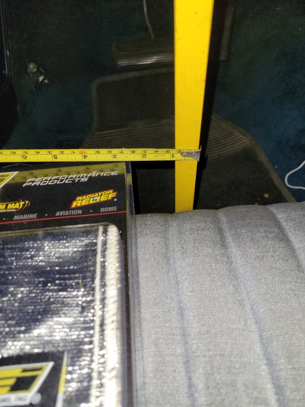

Here you go. By my calculations it's just over 2"s off at near as spot on 60mm.
Measured the seat in 4 different locations to confirm and happy that though it doesn't need to be 100%, that's the number.
To me this is a massive difference and puts it nowhere near the factory mounts. I will need to check by taking it out again, but I would say that the outer mount will be near exactly at the base of the hump, so a PITA to get the seat flat, in which case I will need to raise it for a flat mounting face......
I could do an offset plate from the factory mounts.....
The right side face of the spirit level is the centerline of the steering wheel.
I’m assuming these are not A body seats? All the seat tracks for the various body styles are supposed to be the same, is it anything to do with the way the tracks are bolted to the seats themselves?

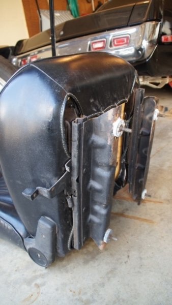

A body seat mounts, are yours like this?
- 1CFC90B9-4BCA-4843-8A74-87C0D30359B3.jpeg (69 KiB) Viewed 2889 times
No both are flat on the runners (so remove the offset z angle).
Weird thing is, by my view of that photo, it moves the mounting point to the inside of the factory bench hump, but still leaves the seat in the wrong position as the runner would still be 'on' the hump.
