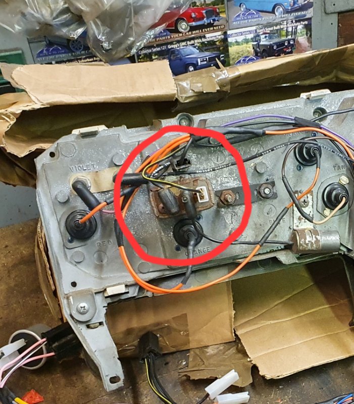

As said previously gauge fault sare probably this,
poor running more likely a coincidence.

It hasn"t affected the alternator gauge, oil warning light or handrake warning light, or the wiper switch, wipers, lights, radio, etc, nothing but the two gauges mentioned.Its a RHD so valiant dash. Don"t know where to find dashboard ballast resister. Electrics is definately not my strong point.

by ScottyDave
It only controls the voltage to those 2 gauges and it should be on the back of the instrument cluster, well that's where mine is.

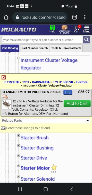

by cadboy
sounds like the regulator has had it , so need to find it behind the instrument panel and replace, then hope all is back to normal.
