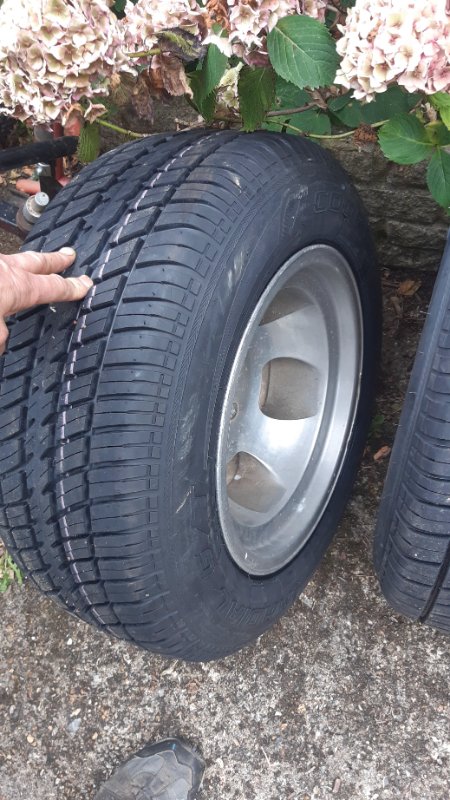

Got some new tyres on today, found some marks on the back of the slot mags saying size (15 × 8.5) "wheel dist inc" and "Ontario Cal" so nothing special I'd imagine there were loads of people making wheels back then

by Blue
By the shape of the slots I’d say those are Shelby Cal 500 wheels, probably my favourite slot mag style.
