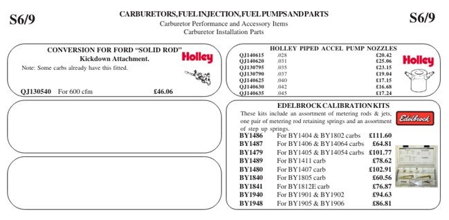

Posts: 1398
Re: 318 carb tuning
Hi Mr Oak :D
Real Steel in Uxbridge do several Edelbrock tuning kits for various model carbs. Check to see if yours is on the list.
if you look on their website 'realsteel.co.uk' and under 'fuel systems' go to page S6/9.
as per pic below.
I was going to attach a link but it says it's not secure ??
I've had a couple of these and the do contain rods, jets, springs etc.
hope this helps, Stuart.
real steel.jpg (40.69 KiB) Viewed 4964 times
