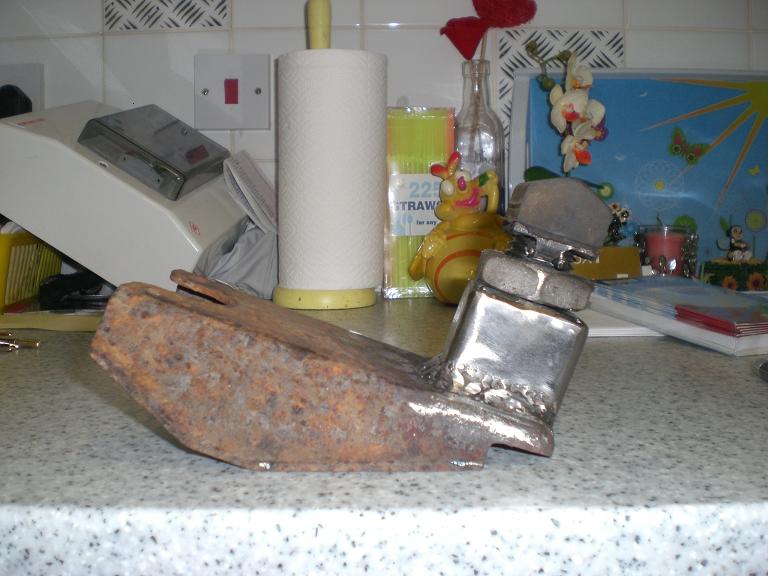

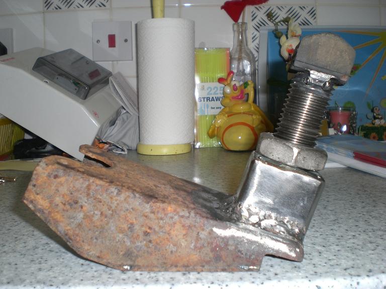

Here are the finished results of the adjustable pinion snubber I made. This is the one I made for Derek as I have still got to collect a pinion plate up from Paul500 and then I will finish mine.
Up Position
Up Position
ANTON

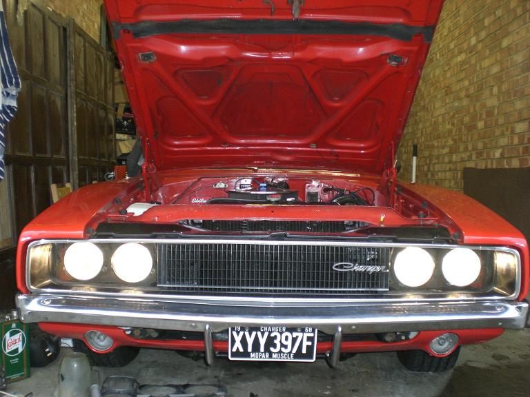

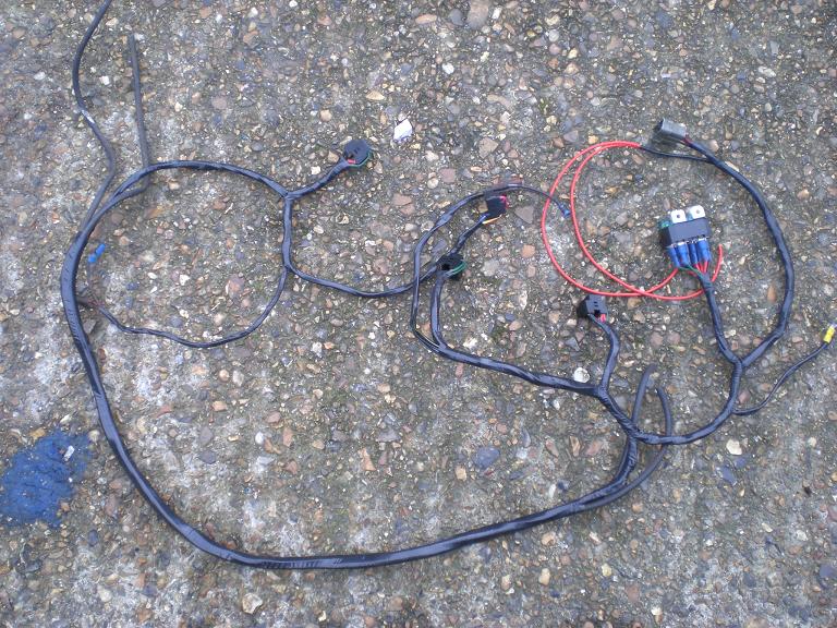

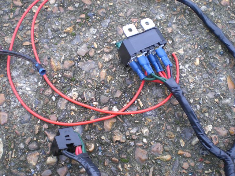

I've done a couple of bits on my car over the Christmas time ant the best of which was to up-date my headlight wiring and headlights. I brought 4 new headlights (from Auto Electical Supply) which take an H4 bulb so I can now have all four light on Dip and all four on High beam. I decided to replace the whole front harness with larger diameter wire and I also added two relays to improve the voltage getting to the lights. Power for the light come directly from the alternator and the original switch wire operate the relays to turn the lights on and off. The improvement in the light quality is astounding and I can now see very well in the dark. While I was at it I got the hood indicators working and I also added a second earth strap to the body directly from the battery.
The results speak for themselves
New bulb connectors and fused relays
New Harness
New Harness

What's the rubber bit on your snubber from? Handy looking item :-k
The rubber is the original pinion snubber rubber relocated to the top of the treaded bar.

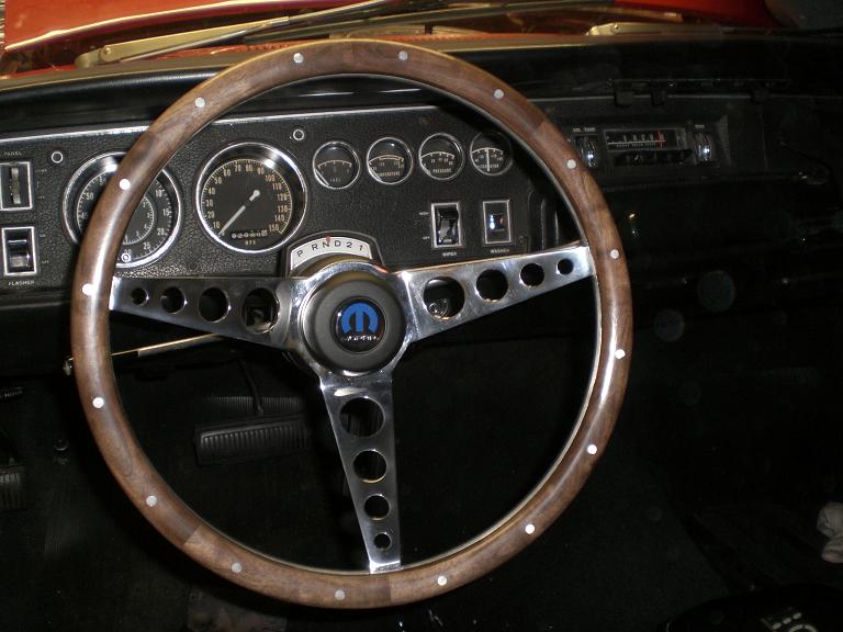

Now that the article has been in the Connected I can post a color picture of my steering wheel.
Steve thanks for the nice article in Connected it was worth the wait.

Lovely job & a good read Anton :thumbright:

Anton
That steering wheel is a credit to you .... well thought out and looks super
