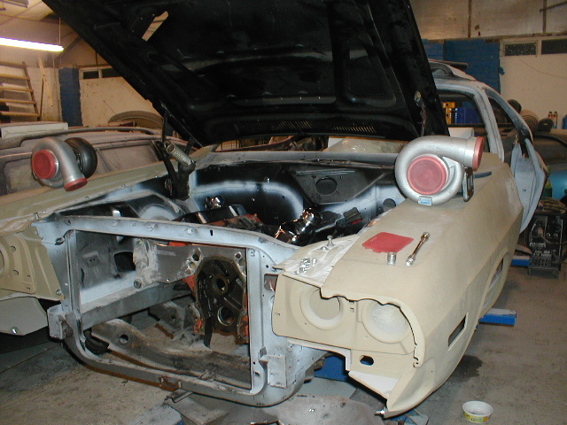

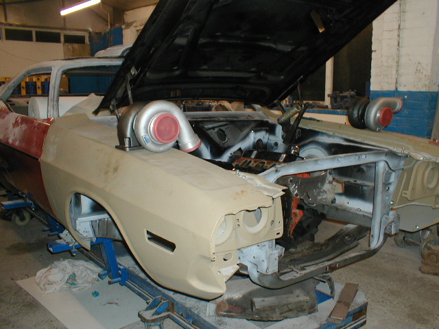

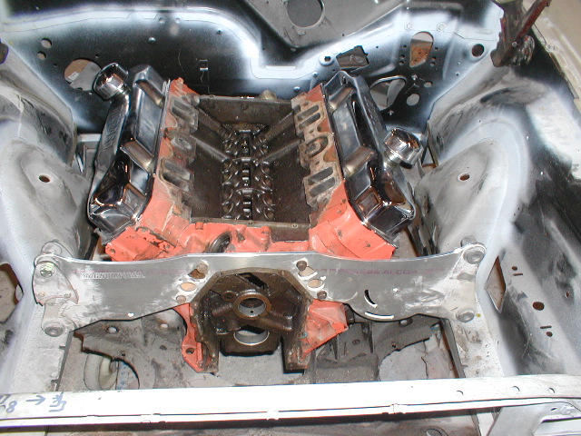

finally got engine in position after juggling with mounts, just have to mock everything up now, motor mount takes up more room than i expected :roll: not going to be much room left when turbos are in there :)

Jeff
Posts: 7972
Location: Ontario.
Post by Jeff »
Damn! Respect right at you! =P~

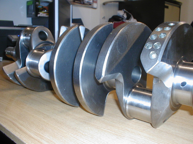

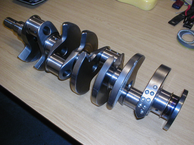

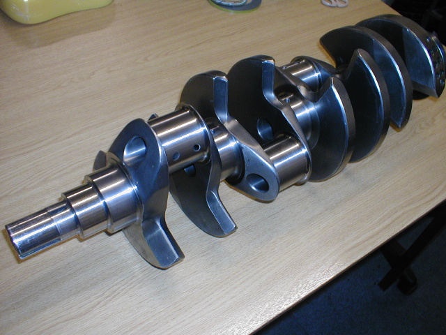

crankshaft has arrived, shame it wont be seen, machined from billet,gun drilled on mains and b/end, can take upto 24 weeks to have made at a cost of $3000.
