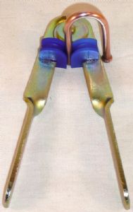

Morgan, I have got a small hand held pipe bender like the one in the picture, specifically for 3/16 tubing. Useful little thing, came in very handy when I bent my kunifer brake lines up. You are more than welcome to borrow it. :thumbright:
Rich.

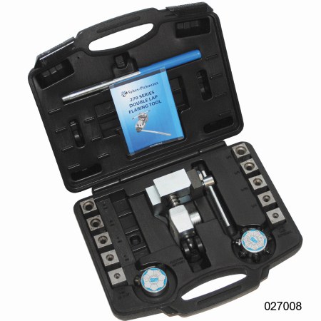

Yes, I've got one of those as well, very handy. I've got another one for larger bends also. I use a Sykes Pickavant flaring tool that fits in a vice to make life really easy.

Yep,that's the Sykes kit I have,although mine is the earlier version without the turret style formers.And it's in a quality tin box :thumbright:

I got a 9.99 ebay flaring kit- utter utter Bananarama! :?

I struggled with cheap flaring tools for years, they really are a waste of money.
