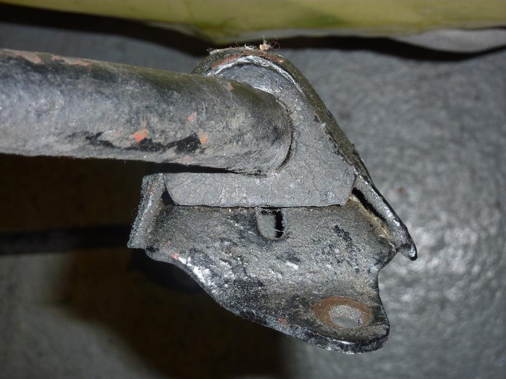

Anyone found an easy way of changing front sway bar bushes?
We can hack the old ones off but as the sway bar has a wider, flattened end, it's not readily obvious (to us, at least :tongue3: ) how to get the new ones on, which come in the same triangular shaped bracket.
First thought is something like washing-up liquid but dunno if that would be sufficient with the metal bracket retaining the bush :?
Stu asked Jim, with the Viper-blue 68 Charger, and he cut & rewelded his.
sway bar bkt1 (Large).JPG (102.01 KiB) Viewed 741 times

the factory type , is a night mare , at worst you will end up in A&E , best you will get it almost in & it will slip off , vice grips , G clamps will go flying !! every time !! use some form of lubricant on the bush , just makes it worse !
what i done , was to cut the bracket also , prise it open , fit bush , close it up in a vice , & carefully mig it back up , one tack at time , & let it cool ,
15 minute job this way :thumbright:
the other way all weekend , muscle strain RSI in hands , possible A&E adventure other wise , & then order up an aftermarket swaybar :lol: :thumbright:

I carefully ground off the factory weld,fitted polybush and rewelded. No other sensible way to do the job.

latil wrote:I carefully ground off the factory weld,fitted polybush and rewelded. No other sensible way to do the job.
yeah rings a bell !! think i did grind the weld away now rather that cut !!!
done mine a bout 10 years ago , so my brain could be remembering anything , will check later :thumbright:

:thumbright: just had a look , yep no cut , grind factory weld
Great, thanks for the advice all :thumbright:
Looks like it's a grinder & maybe a trip to Jim's to beg a favour with his welder :?

I drill one side of mine for a bolt and then grounf the weld off the same side and then opened up the bracket and fitted the new bush and that use a nut and bolt to hold it all together.
Drill the hole before you grind the weld off, to keep it all aligned. I put the bolt at the back so it can't be seen.
