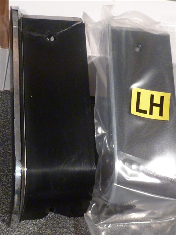

We recently received some parts from Year One inc these dash trim pieces, that go at the extreme ends of the dash, at the same level as the glove box lid.

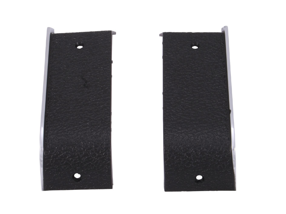

Our originals are a smooth finish (see pic below), yet the ones they sent are textured. The pic below of the 2x textured parts is nabbed off the PG Classic site, but they look identical to the Y.O. parts.
We queried it with Y.O. but they say they only have the textured style, despite their website saying there's a smooth & textured option. It's been suggested elsewhere ('For B Bodies Only' site) that they may be a 1970 item and are only producing this type and passing them off as 68/69 too.
Has anyone with a 69 Charger or Roadrunner WITHOUT A/C got any pics of their dash that shows these parts, so I can see if ours are original/standard parts and also to check whether the Charger has the same parts?
I say without A/C cos I think they use this part as a vent, so is completely different.

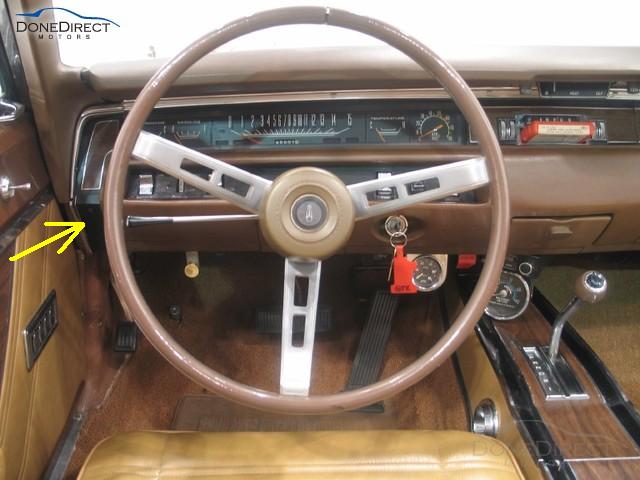

This bit, arrowed (both ends)
69 GTX-arrow.JPG (44.03 KiB) Viewed 1053 times
Ours on left, Y.O. on right

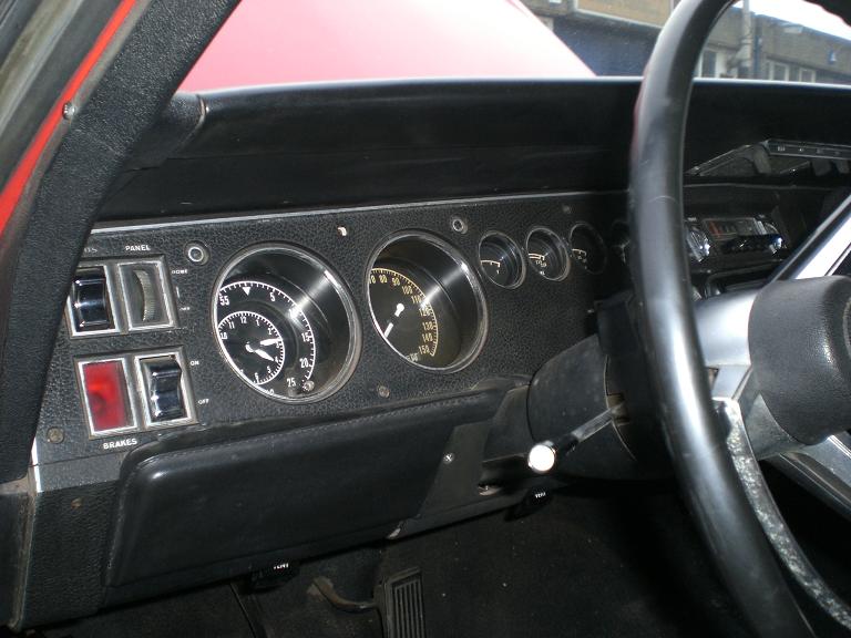

On My Charger they are both textured.

ANTON
Posts: 2046
Location: Sutton,Surrey
Post by ANTON »
heres a picture of mine

pretty sure all 69 -70 rallye dash , non A/C B-bodys , had the pebble grain , except an SE , the smooth corner piece , is for the standard dash cars !! , coronets / satalites

Looks like it might be just the Sport Satellite & GTX that get the smooth version then :roll:
And maybe the SE Charger...... any 69 SE's out there? :lol:

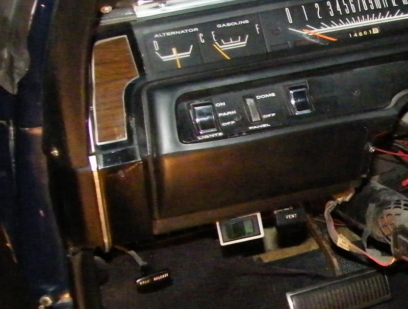

dash
Hi rob mines got AC and is wood grain not much good sorry. :(
Woodgrain? Hasnt it got vents in? :scratch:
What i ment was my car has A/C and the dash is woodgrain so i have a vent. :lol:
