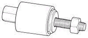

Always best to press them in and out with the correct tool otherwise it is easy to damage the control arm.
Mind you. The "correct tool" can just be thick wall tubing, a large 1/2" drive socket, an assortment of washers, and the long bolt from a three or two leg puller. :thumbright:
Anything that ends up looking something like this...
