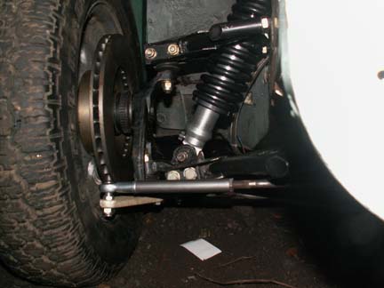

Here is my set up would I do it on a roadcar? no.
Sus 010.jpg (39.78 KiB) Viewed 507 times
