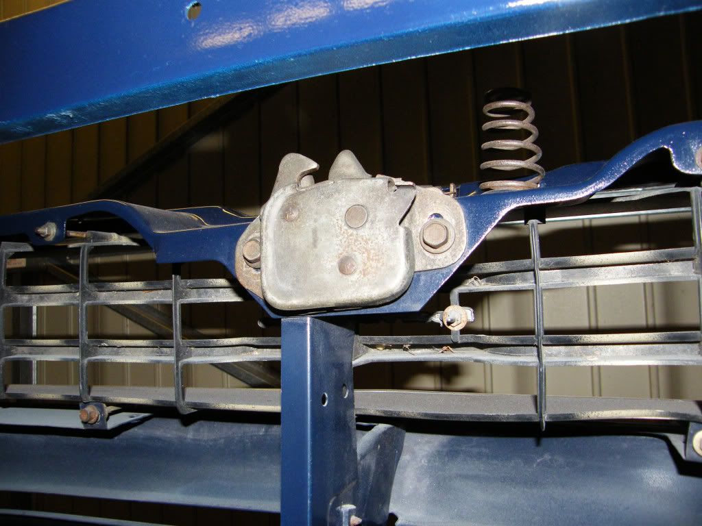

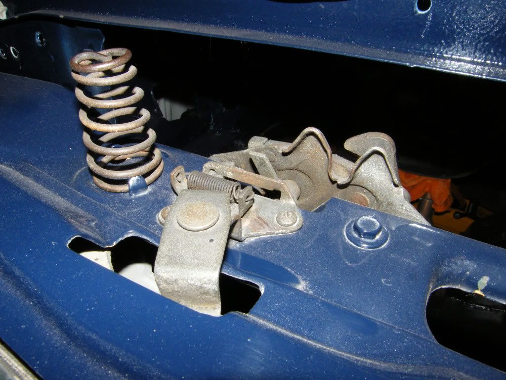

Any idea what finish the hood latch/catch assembly should be on our Satellite?
I presume it had some kind of plating when new.... zinc?
Clear as opposed to colour?
I think someone said recently (Jim?) that the spring should be black? Is that plated?
And if the mechanism is plated, does it need completely dismantling first or would it bind up when operated, if we just get it plated as-is?
Cheers :thumbright:

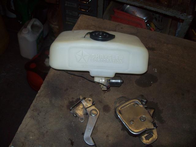

Bare metaled mine and put a clear laquer over it.
103_1656 (Small).JPG (32.42 KiB) Viewed 322 times

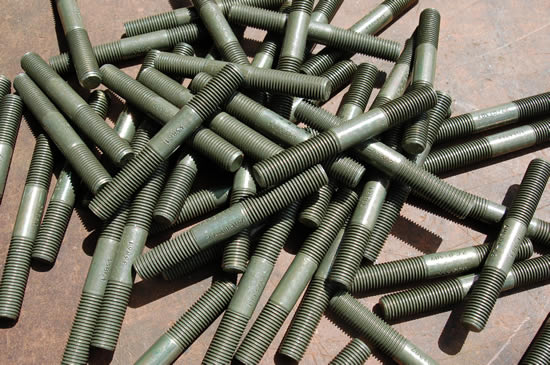

Olive drab zinc looks a bit closer? But again, that can vary in colour :roll:
Might end up just cleaning and laquering - I dont think it's visble from the front thru the grille [-X
