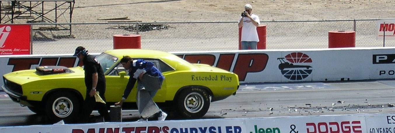

Trans failure!
Trans failure!
Sould have gone to Dunc!
- Whoops, should have got a Dunc box..jpg (181.06 KiB) Viewed 274 times

yep thats what you get when the rear roller clutch flips and the high gear clutch drum spins way to fast its a powder casting that has no real strength when in a high rev situation, and it explodes
plenty of people racing Tflites with a factory drum in it lots of money on an engine but wont cough up £750.00 to protect their
transmission/car floor pan/headers/LEGS AND FEET, yes an exploding torqueflite will tear its way through the transmission case and car floor pan,

Yep thats a Biggy!
Anyone running quicker than 11's has this dilemma?
Guy standing next to the door is the driver, both feet intact!!!
Lucky lad indeed.
Nothing wrong with a 727, just need the right bits in there and the Jobs a gooden!
Baccy.
ps, its not the sweeping up of the bits that's a prob, its the two gallons of hot trans oil that's the problem!
Try explaining to the twenty guys in the line behind you!!!
