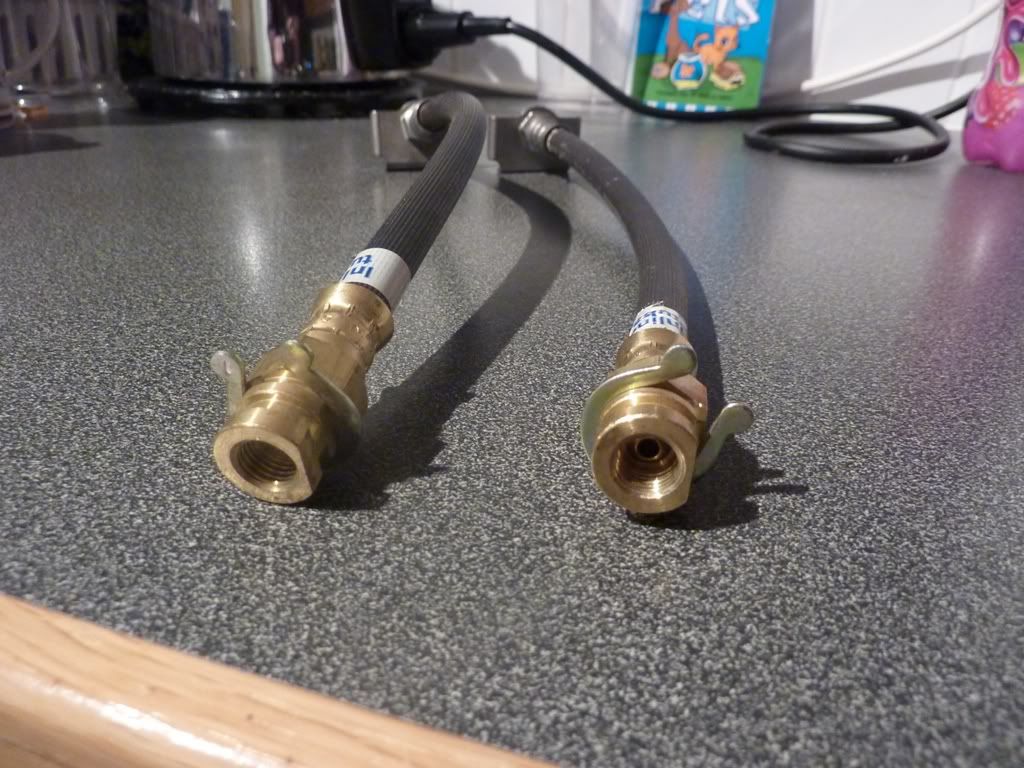

I was going to start a thread to ask a brake hose question but I may as well stick it in here.... if that's ok Dave, but it may help ;)
We got a pair of front brake hoses from Inline Tube in t'States, and now we've (ie Stu, again) has come to fit them, we've come across a little problem/query :roll:
The hoses are identical to each other but it looks as if they need to be handed to mount to the bracket on the caliper - 1 fits ok but the other looks to be 180° out
Only pic I've got to hand is this one showing the hoses...
Has anyone else got these hoses and managed to get them both to fit?
Unfortunately we havent got the original hoses to compare with; they got slung out a while ago :(

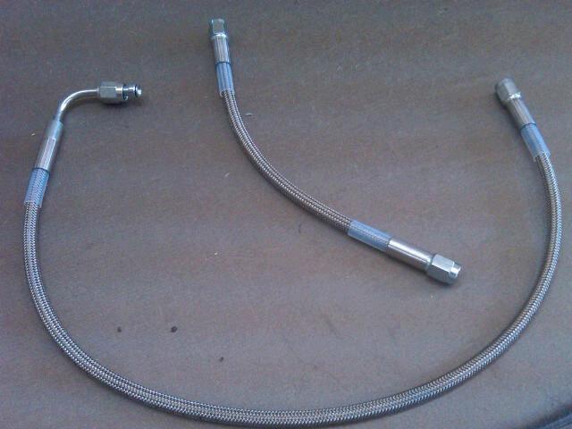

I keep a selection of pre made braided hoses with -3an ends
brake pipes.jpg (35.68 KiB) Viewed 665 times
Posts: 4232
Rob - I have the same, all fitted and mounted OK... I did not differentiate between left and right. Can try take a pic for you or pop over and have a look if you want ?
I got mine from inline too.
Posts: 13917
Panic over #-o
Both hoses on now :oops:
