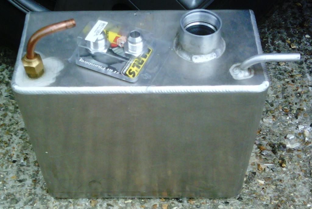

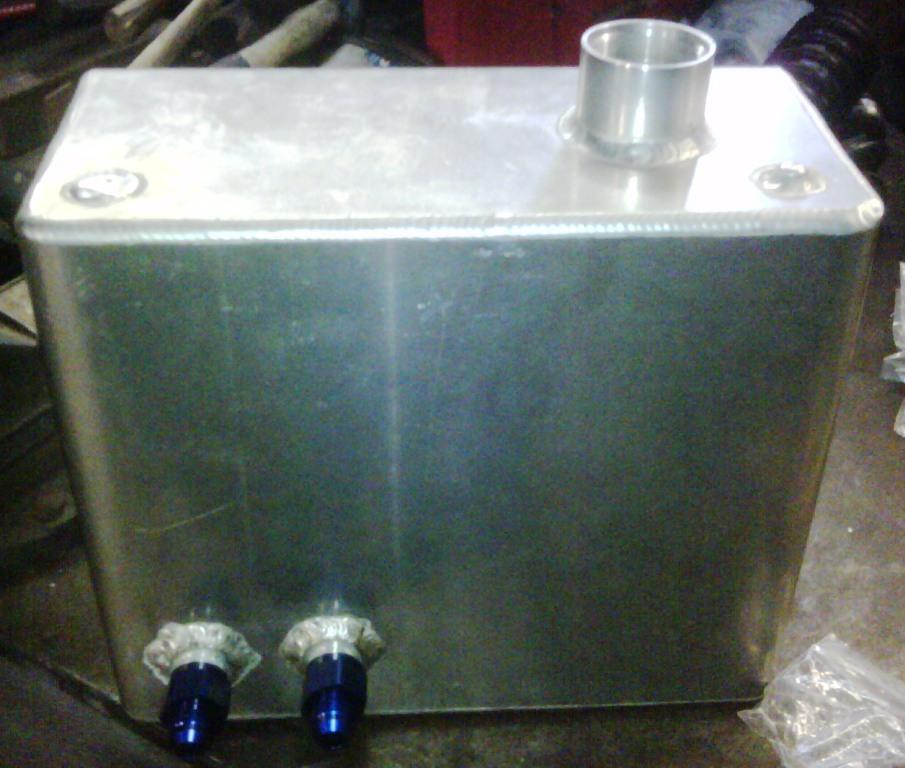

Determined to sort this fuel pressure issue !
... am pretty sure the current single 3/8 outlet is not keeping up with fuel demand ??
Existing tank has come out and I have welded up the fuel outlet and vent on the top.
Have fitted 2 new -10 alli bungs near the bottom at rear and am using a vented cap with rollover valve to let air into the tank.
A second -10 insulated fuel line is going in with redtop pump for NOS and blacktop for carb. Each with its own aeromotive filter and aeromotive fuel pressure regulator.
Just hope it stops raining
