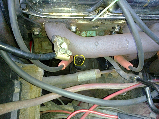

Just so I know that I'm trying to adjust the right thing on the box, When you say back off the adjuster, do you mean loosen the nut in the first pic below with the yellow circle around it?

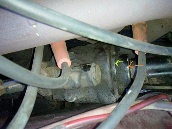

Does unlock locking hex ring round column head of box mean the bit with the orange arrow pointing to it in the second pic?
does knock the alluminium box end, that you just took the lock ring off round to tighten it up, mean the bit with the green arrow pointing to it in the second pic?

adjuster between sector shaft and bllnut is ringed in yellow
undo lock nut
wind out the bolt about 1mm
the lock ring is arrowed in yellow
back it backwards a little and then wind it out a couple of mm
the orange arrow points to the alluminium end of the box
wind it in a little bit
howver i must admit although your box looks like others i have seen that bit highlighted in ornage doesn't
undo lock nut
