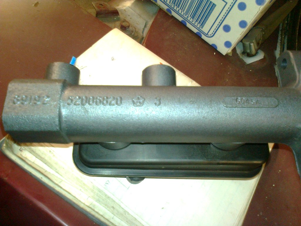

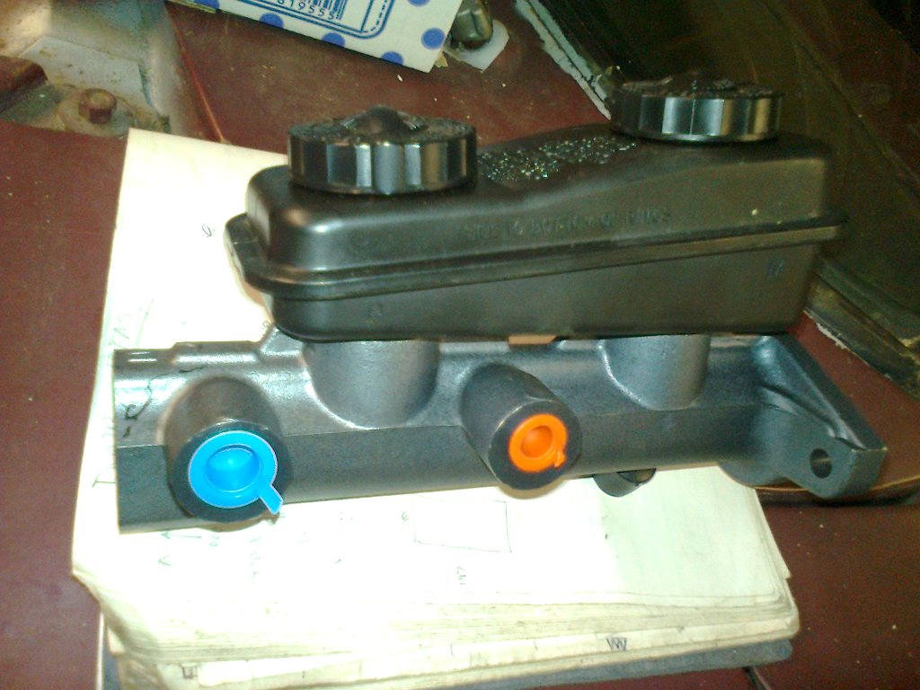

Which half of my m/cyl is front & rear?
Brake m.cyl 02.jpg (126.74 KiB) Viewed 441 times
Brake m.cyl 01.jpg (124.72 KiB) Viewed 441 times
Guy
Posts: 5002
Location: Behind a Camera
Post by Guy »
Normally the one at the rear is the front and the one at the front is the rear if that makes sence :?
Cheers Guy, i suspected that but didn't want to say it out loud...
Guy
Posts: 5002
Post by Guy »
I said it out loud and it still sounded odd to me :lol:
Jules
Posts: 1850
Post by Jules »
Guy wrote:Normally the one at the rear is the front and the one at the front is the rear if that makes sence :?
Orange front, blue rear.
Shoud be anyway :shock:
:D
MMA/750
Sorted :D
