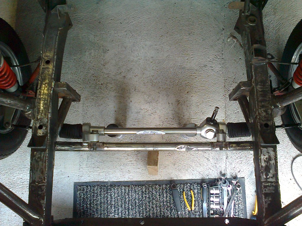

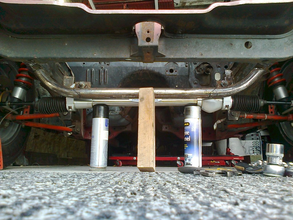

I finally have the rack in the right place and tack-welded in :D
It took most of yesterday to get it lined up and all that did was prove how badly the A-arm mounts were out of line :roll:
I got the rack millimetre-perfect level and centred in all planes, only to find one wheel kicked out at the back. This could only be due the bottom A-arms being unequal.
Luckily they're adjustable on the rod-ends so i managed to get the wheels symmetrical without any more cutting & welding. Obviously once i've got registering sorted it'll still all have to come off but it's good enough for now
Rack in place, ready to weld 02.jpg (243.91 KiB) Viewed 925 times
Rack in place, ready to weld 01.jpg (178.52 KiB) Viewed 925 times

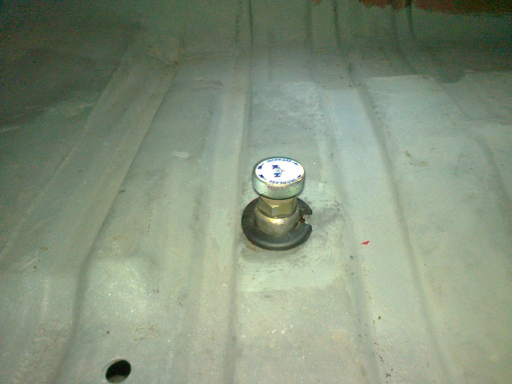

Brakes pretty much sorted now with Daisy's assistance :thumbright:
I've made all the brackets & run the cable, we plumbed in the copper lines and mounted everything. Just waiting on a couple of adaptors to connect up the Linelok and i can bung in the fluid.
Only concern is i didn't allow for the Z-bar, may have to re-route a bit when i try to fit.

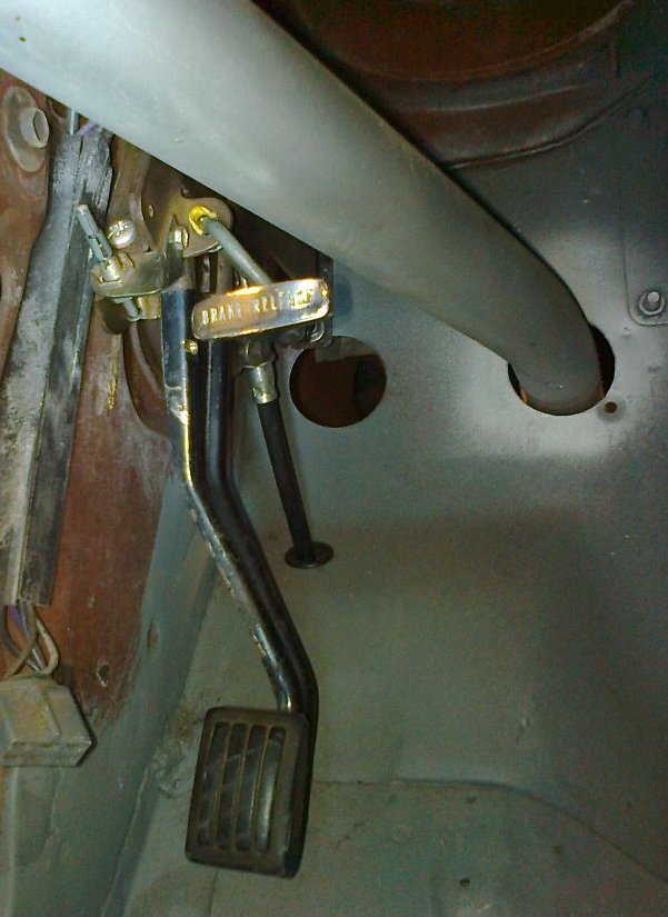

I've 'adjusted' the Parking brake release handle to clear the cage.
I had to drill the cage outrigger to route the cable.

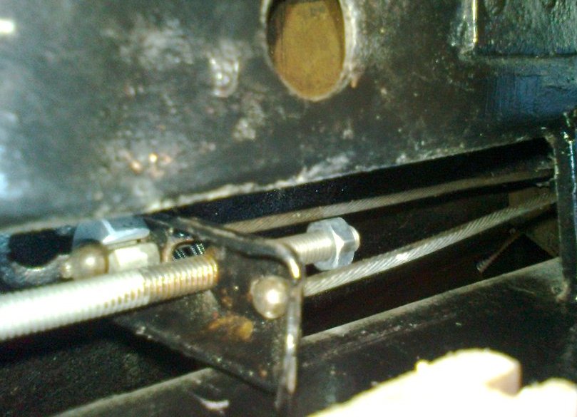

I made this guide for the turn in the Parking brake cable. It may need to be stronger but it's bolt-on so i can re-do if needed.

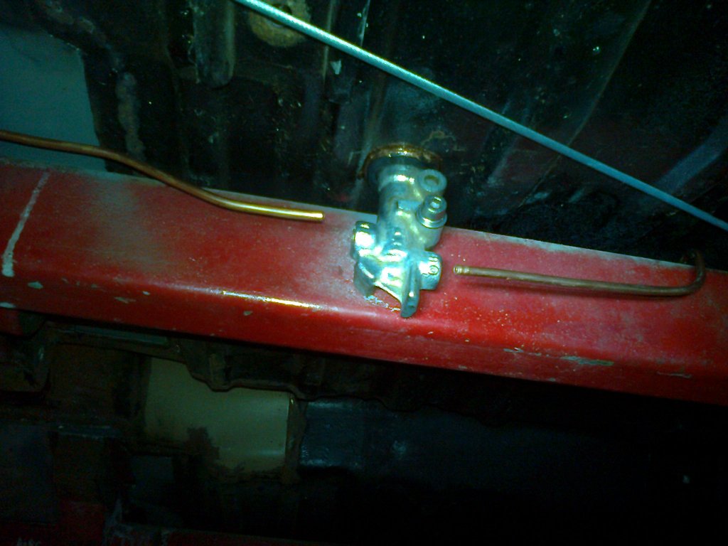

I've cunningly located the bias adjuster so the knob appears under the seat.
The rear cable inners were differnt lengths so i made this little spacer. They may equalise once it's all under tension. If so, i can simply take this out.
07 Brakes- Bias adjuster 02.jpg (119.89 KiB) Viewed 868 times
06 Brakes- Bais adjuster 01.jpg (104.57 KiB) Viewed 868 times
05 Parking brake- front cable guide.jpg (159.88 KiB) Viewed 868 times

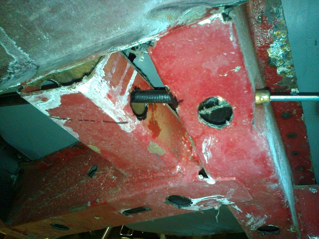

This is the plate for the rear cables, again it's bolt-on so i can move or relocate easily if it turns out bad ;)
09 Parking brake- rear cable bracket.jpg (153.81 KiB) Viewed 867 times

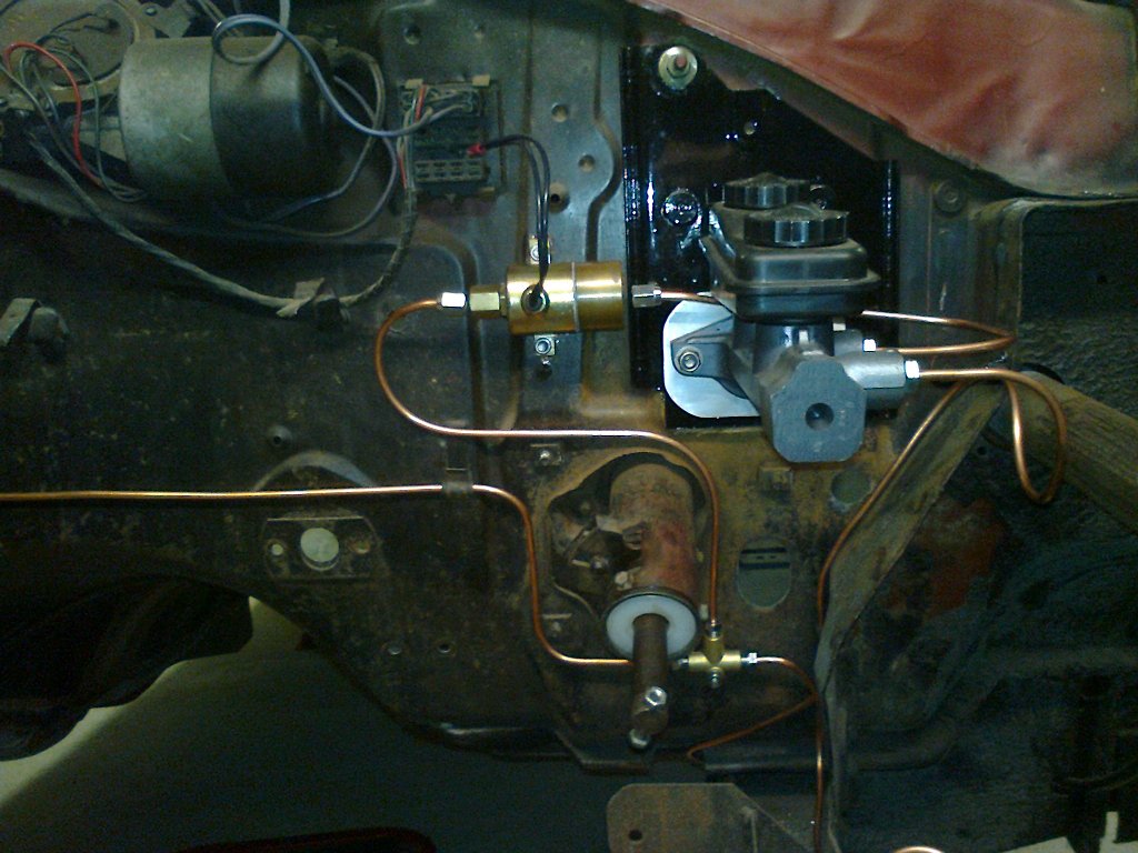

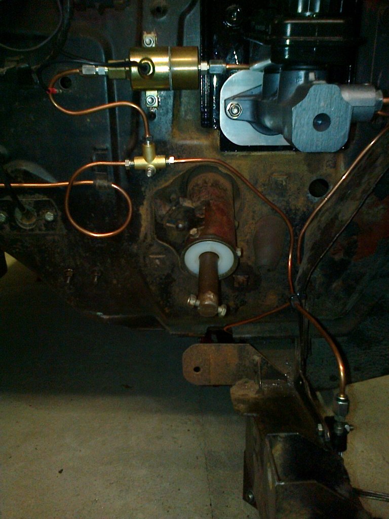

I have WORKING BRAKES!!! They need re-bleeding but there's pressure there and the linelok and parking brake work.
I re-routed the pipes below the m/cyl as i realised they'd be in the way of the clutch rod.
Rerouted brake pipes.jpg (133.53 KiB) Viewed 825 times
