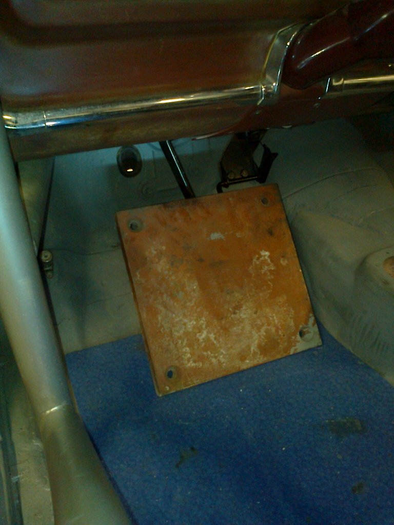

I made a bleeding tube by blocking the end of a pipe and making a razor cut in it to make a one way valve. I bled in sections, first to the bias valve beneath the seat, then to the T on the rear axle, then each rear wheel. The fronts i went straight for the calipers, they have two bleed nipples on each so i started at the furthest.
Each time i wanted to close a bleed point, i held the pedal down with a handy steel slab. Worked brilliantly
