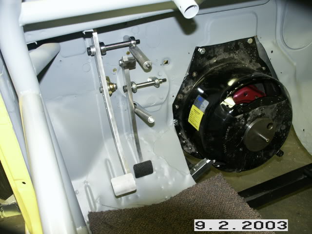

Liberty equaliser 5 speed with dual bonanfonte clutch
