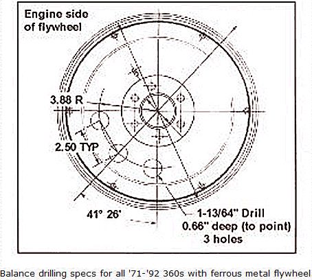

I'm learning how to I.D. your flywheel.
360- Cast crank. Externally balanced. Has 3x 1 13/64" holes, see pics...
360 flywheel drilling.JPG (53.86 KiB) Viewed 535 times
360 flywheel.JPG (44.42 KiB) Viewed 535 times
ALL V8 flywheels have 2 mounting bolts closer together.
SLANT 6 ones are evenly spaced.
Hemi and race types usually have 8 bolts
ALL B.B. (except 440 cast crank), ALL 318 and early 340 FORGED crank motors are internally balanced and use a NEUTRAL BALANCED FLYWHEEL.
FROM MID 1972, 340's changed to CAST CRANK with external balancing. The Flywheel changed to EXTERNALLY balanced, but NOT THE SAME AS THE 360. The holes are different- these have 3x smaller holes near the outer edge instead.
130-tooth flywheels are for 10.5 or 10.75" clutches.
143-tooth flywheels are for 10.75 or 11" clutches.
Please correct if needed or add to this (more pics would be good), I'm only going by my intrerenet reasearch... ;)
