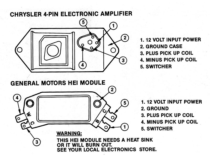

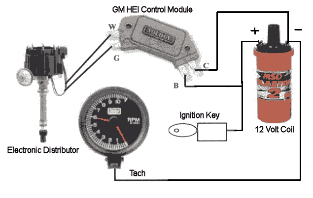

autofetish wrote:Yes there is fuel system and msd ect but i would have to invest that even with a non blower engine
MSD my Arse
if you were racing yes..... but yer not
why spend 200+ quid when you can have a reliable igntion from our firends at GM using your orginal Dizzy and any modern frame coil off a mid 80s "classic"
£20 for the module
http://www.ebay.co.uk/itm/E-TRON-D1906- ... 5ae2ce2e7c
GM 4 pin module
modern laminated frame coil
like this
http://www.ebay.co.uk/itm/1974-75-76-77 ... 4836f867f5
get rid of the ballast
bobs yer uncle
if it can set off LPG in engines with 13.5:1 CR then it can work perfectly adequatly in a low boost blower/turbo set up
i'd invest the money in MLS gaskets or copper....ferriday egineering do copper from you old gasket as a template
http://www.ferriday.co.uk/

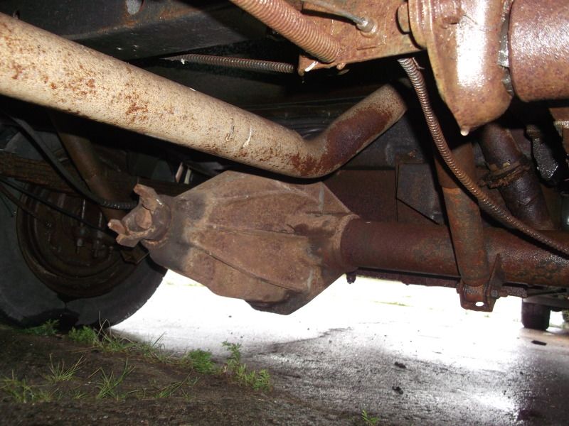

Q. Is this axle a dana 60 it is Bananarama! huge :shock: :shock: :shock:
Next plan is to strip out and do a diy dana 60 (on the cheap )

Posts: 6738
Does the cover plate look a bit like an octagon shape or should i say a 60 has this type of cover plate ?
I'm no expert, I seem remember from when I was looking at them, no doubt some one will be along to confirm or put me right :D
Adrian Worman
Posts: 4376
Location: Milton Keynes
Post by Adrian Worman »
60's, 70's and 80's all have a similar cover but you can identify em fairly easy.
Some have the series code cast into the bottom right of the centre section but you'll probably have to go on the web to get a chart which clearly shows the differences., there's loads of info on there.
It's probably an unequal length axle so the shafts will be too and they are probably 8 stud commercial hubs too.
Unfortunately it's unlikely to have a locker in it either, sorry :D
Jesus built my hot rod
72 Challenger
65 Barracuda
Posts: 22109
3 or 4" tubes? Some of those brackets will need to come off..
What are the gears and width Drum to Drum?
Pete wrote:3 or 4" tubes? Some of those brackets will need to come off..
so they are 4 inch tubes
from backing plate to backing plate its 4 ft 10inch
one side tube is 1 ft 10inch the other 1ft 5inch (from housing to backing plate Just tube)
Tag on back plate is 41-10
4-10
Case is stamped B27278
Its a open diff on the main gear is stamped
8 30 78
DANA
34840
F2N1
41-10
also stapped on gear looks like a kid did it is 262
The bearing caps have 0257
:help:
