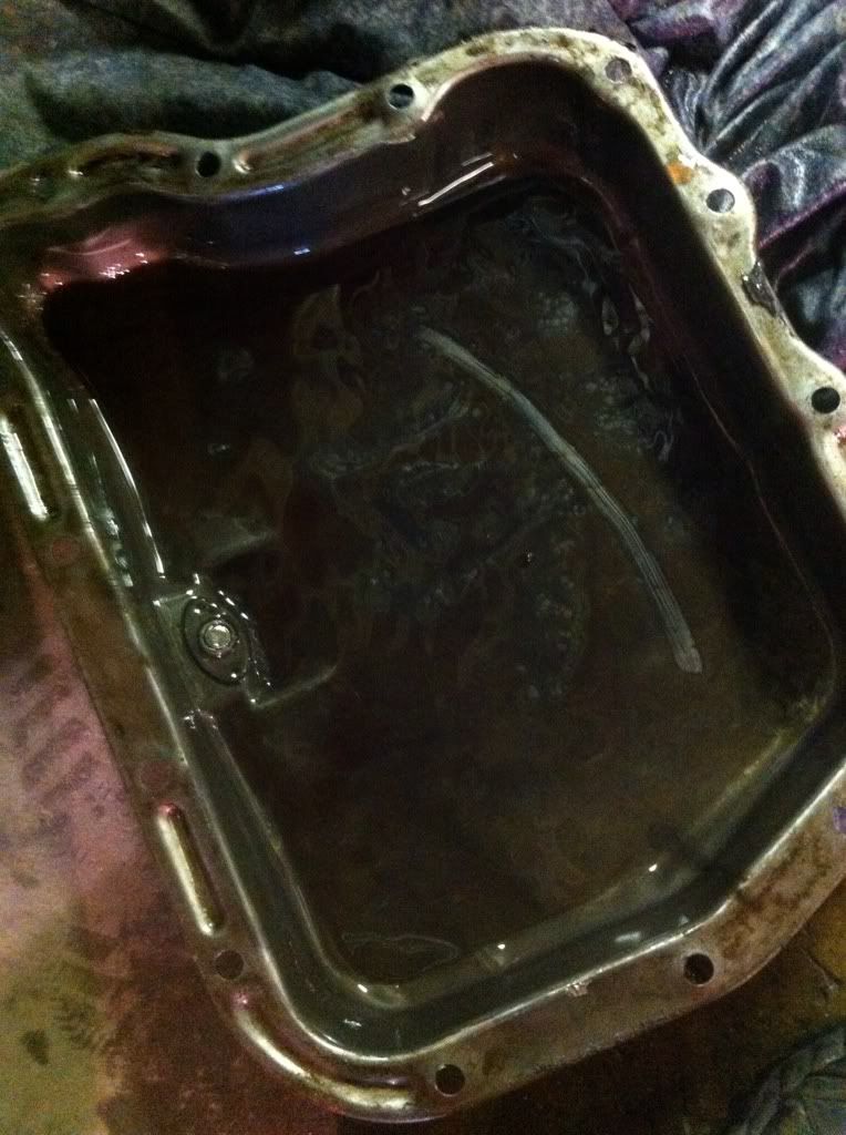

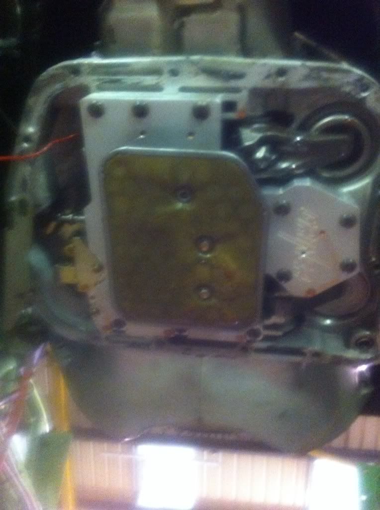

Hello there I have a 727 with griner valve body .
It's meant to have had a b-m kit put in it new clutches etc . It's had a small oil leak from trans brake pulled it apart and in the bottom of the sump there is quite a bit of slunge and what looks like fine metal partials . Also bang in the middle of sump is a pile of something ?? It's done about 3 miles
Posts: 22138
I'm not an expert but the words "Start again" spring to mind. Sorry.
That also goes for all the trans cooler lines which need to be clean and also the Torque Convertor, which will probably need to be cut open and cleaned.

3 miles!?! Did you have it built at the same place that built your engine?

See it maybe ok , but a wee bit nervous after the state of the engine . And I couldn't possibly comment on who did it . :twisted:

a major problem amongst people that profess to be able to build transmissions is the cleaning anyone can fit new clutch plates and seals but plenty do not completly strip the full transmission and valve body and clean it to as new condition before resembly,
i can Bananarama! building a trans in a day if i have to but it will take me 4-5 hrs to clean it all first and then to strip clean rebuild a valve body another 3-4 hrs
if not stuck valves crud floating around in the fluid etc etc,
dont get me wrong i have had failures very often due to a part breakage or similar but i try to give it the very best chance in the first place,
There is no way that was built correctly.
To do it right you have to strip the box down to a bare case anyway. To fit new seals and get the correct clearences on each sub-assembly, with correct thickness washers and clips, you have to pull each sub-assembly apart.
A transmission is actually a very rewarding thing to rebuild. I'm not nearly as good as Duncan so I have to take my time over two weekends and a few hours during the week.
It is probably the most interesting and rewarding job you can do on a car. So why anyone would take short cuts is beyond me.
I also brought abox off eurodragster for 200 quid was fitted in a race car but was rebuilt 4 years ago and used for racing. My sump pan look the same.
I could never build a gearbox i think im along way off that.
I have cleaned everything i can and convertor.
Changed filter and fuilds and will give it a go.
If it goes bang or dont work. I will then look at having it rebult.

When I did my city and guilds in auto boxes the teacher went on and on about cleaning it was the most important part in the rebuild. It takes longer to clean a gearbox than rebuild it. I must say though that I have rebuilt a box a the pod and it run for years after with no problems and I have rebuilt a chevy box in a field covered in mud and that went on for years after. Just lucky I gess

Yep agree the cleaning is very important.
You would be surprised how much muck from friction material and what looks to me like very fine aluminium particles settles in the valve body in a used box that looks clean inside the pan and around in inside of the case.

It is not that unusual to have a little friction material in the bottom of the sump after they have bedded in a bit after a rebuild.
But only after many more miles than that and a good few hard passes up the strip or your local public "test track".
