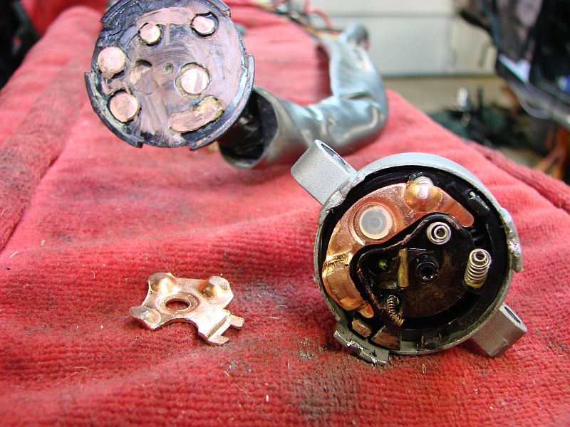

Drew that sounds like your problem could be the ignition switch (they die after 40 years) or a bad connection in the connector on the column
It is the switch , and it is only 5 years old :oops:
The pot metal body has gotten loose with the plastic wiring harness and when I would turn the key it would flex and separate,and loose connection/contact
and the spring inside is knackered so a new one is on order I hope it lasts longer than 5 friggin years for crying out loud :x
DSC00092starter switch.jpg (123.47 KiB) Viewed 148 times
I am right sometimes then. :D
Dave wrote:I am right sometimes then. :D
Yes indeed the fact is I posted this and it made me think and not assume the switch was bad
I thought it might have been the MSD box or something else but since the switch was only 5 years old how could it be bad? ...............well it was bad ,so good on you Dave

Yes I almost did that , and in fact since the units like to fail I want to do some thing to give the new one more life :?
