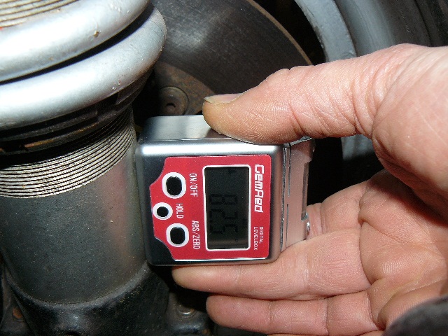

This is the best £30 I've spent in a long time :thumbright:

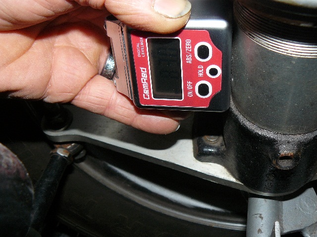

You calibrate it yourself to the super-sensitive bubble on the top then just sit it on any surface and read off the angle relative to your calibrated level. (you can also zero it to any angle)
It's accurate to 0.1 degree, has a magnetic base and has a hold button for if you can't see the readout where you want to measure.
It's a hell of a lot easier to use than a pendulum-type angle finder.
It took about 10 mins to get all my prop angles and steering angles logged with no guesswork. Ace!!

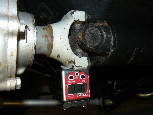

Level 5. U.J. flange 2.4.jpg (133.86 KiB) Viewed 617 times

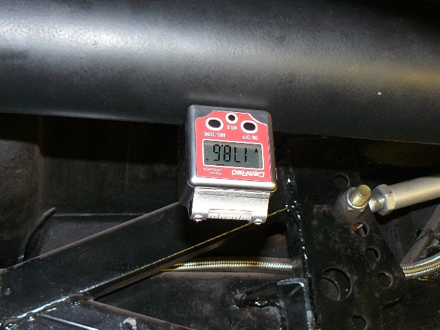

Level 3. Prop 1.4.jpg (148.46 KiB) Viewed 617 times

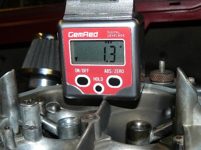

Level 1. Carb 1.3.jpg (151.09 KiB) Viewed 617 times
Steering angles need some attention too...
8. Castor Right 83.0.jpg (135.44 KiB) Viewed 609 times
7. Castor Left 82.5.jpg (142.5 KiB) Viewed 609 times

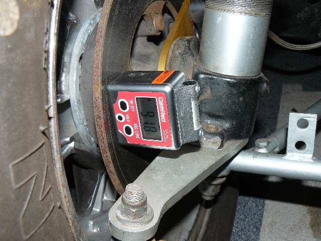

6. Camber Right 91.8.jpg (136.75 KiB) Viewed 609 times

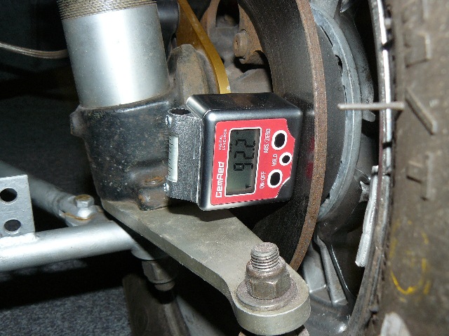

5. Camber Left 92.2.jpg (132.08 KiB) Viewed 609 times

The only problem I always have is finding a reference flat or verticle surface. It looks like that thing sorts itself out with it's own level? I could have done with that years ago.

It will be interesting to see how easy (if at all) it is to set up the Caster on a stock MoparFront end...should have thought of that before I bought one :roll:
Mind you, I really got it for Pinion angle set up :thumbright:

Pete wrote:It will be interesting to see how easy (if at all) it is to set up the Caster on a stock MoparFront end...should have thought of that before I bought one :roll:
Pete, all you can do is set to max caster (max out on the front bushes and max in on the rears) and then adjust the front bushes back in until you get the required camber. Half a degree if you want to corner hard.
It does reduce caster as you bring it in but there is nowt you can do about it. Depending how well the car was thrown together by Chrysler you may well end up with different caster from left to right side. But as long as camber is the same and the toe correct, it does not really matter.

I was also thinking of standard knuckles using Adjustable top "A" Arms....
You KNOW I don't worry about camber on Stock Mopar set ups ;)
Yup that's what appealed to me. There are cheaper ones without the bubble.
It's satisfyingly heavy too, and quite shiny. Definitely designed by a bloke.
