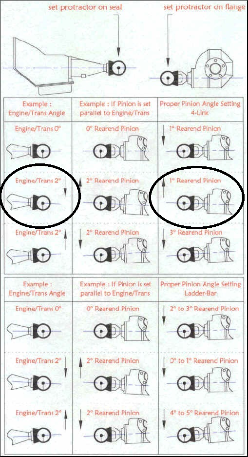

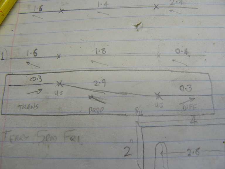

In trying to fix a nasty vibe at 80-90mph I've been checking angles with my groovy new gadget.
Using the chart, I've corrected the diff (as close as I can) by adjusting the 4-link bars.
If my sketch makes sense, does it look right-ish?
- Belve pinion angles.jpg (39.21 KiB) Viewed 427 times
- Pinion angle chart.jpg (144.4 KiB) Viewed 427 times

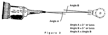

this is just a guess
when the suspension compresses or the engine moves on the mounts the CVs have to bend.
if there is no pinion to prop to tail shaft angle the cvs have a choice which way to go
that choice is assisted in the correct or wrong direction by the direction of change AND the shove forward or backward felt at the slip yoke
if you bias them one way or the other they can only go the way they are biased.
firstly this probably good from the point of view when the slip yoke has gone as far as it can forward, you won't shove the prop shaft up towards the floor out to either side or down towards the ground becasue it can never have a bend in the same direction at both ends. all it can do is get lower or higher at the back which if angled correctly means shorter as well
I also think its necessary to do this becuse any CV joint when rotating causes the prop shaft to speed up and slow down as each quadrant of the cv passes the inner radius of the bend. i.e it tries to go straighter than the bend then is happy to bend further as each lobe of the joint passes the inner radius.
With a big bend the finger from the prop in the bend as alinged with nearly the centre of the slip yoke shaft and the other finger from the prop is sitting outside the radius or rotation of the slip yoke faster slower faster slower etc like inner wheel and outer wheel in a tight corner with a spool in ya diff neither goes the correct speed for the manuver
Now this is the bit i don't understand
with it set up correctly this equal and opposing angle either avoids one end trying to go faster than the other at any point in time
OR
it sets it up in absolute oposition to that, which i guess would smooth out the pulsing seen at the pinion
not sure which.
if you take any prop shaft style jointed bar and bend the joint to an extreme and spin the shaft you can feel the notchyness at the articulated free end...
try it out with lego
the only other thing i can came up with is that that 1 degree is reduced to 1/2 or 0 degrees once you start moving forward and maybe there is no angle during speedy progression on a dead flat surface
but that seems likely to be a scenario that plays out for less than 1% of your motoring time. roads are lumpy and we all like to gun it from the lights
as stated its a guess and could all be rubbish but some of it fits right in my world and until i think of something else

I like my chart as it's the only one I've seen that gives specifics for a 4-link. That doesn't make it right of course
I'm happy to listen to the Voices Of Experience instead.

Cracked it! Told you it'd be a bloody nightmare though
First I raised the trans about 1/2 inch on the jack. This brought the prop uncomfortably close to the prop loop and only changed the angle 0.5 degree.

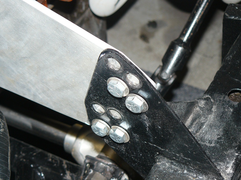

Next I took the weight off the motor mounts with the engine crane and dropped to a 2nd set of holes in the chassis plates which I'd miraculously drilled 'just in case'. (just in case of what I didn't know when I did it!)
This combined with an 8mm spacer plate under the trans mount did the trick.
I now have the trans and the diff at 0.3 degrees sloping up towards the rear, and the prop angled down by 2.9.
- Angles all correct now.jpg (182.55 KiB) Viewed 343 times
- Motor plate extra holes.jpg (210.54 KiB) Viewed 343 times
