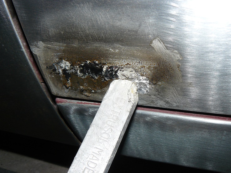

I was taught this years ago when I had a Lancia and this is my first go since then!!
Pleased to report I still got it :D
1. Sink the area a bit with a hammer so you can cover it with lead and no high spots of steel will poke through the lead.
2. Tin with tinning stuff and light yer blowtorch. Cook til shiny.
3. Poke it with a stick. Heat the end of your lead stick and keep the panel hot until you can poke the stick into the panel and it sort of squishes slightly and bits come off and stick to the panel.
4. This is the tricky bit- keep just enough heat so the lead can be worked but doesn't actually go shiny, if that happens it's about to run onto the floor!
3 Loading tinned area.jpg (185.48 KiB) Viewed 340 times

5. Make yourself a wooden paddle cos real one's are bloody pricey! Smear it with plumbers flux or grease cos the proper stuff is bloody expensive! Use this to gently shape the lead and spread it around. Keep flashing the heat on to keep the lead plasticeney
6. It's tricky to tell when you have enough lead but you can add and shape it to your hearts content at this stage.
7. Once you're happy you have enough on there so the whole area is now above the level of the original panel it's time to leave it be.
8. Bananarama! file, fine file, sand, etc
9. Be smug, get a brew/ beer :thumbright:

IT takes a fair bit of practice to get the heat right but it's not that hard really.
Stuff's easily available from any 1/2 decent body shop supplier or ebay.
Filing/ sanding can be done as soon as the panel's cooled enough so it don't burn your fingers :lol:
Ideally you'd want to put plenty of lead on and use a proper body file, then sand it like it was filler to avoid having to fill over it after.
I mainly want to seal my welds and leave a reasonable finish as I've no intention of painting the car for a while...
Oh yeah, don't practice on a vertical panel or your first few attempts will end up in a puddle on the floor ;)
db wrote:IT takes a fair bit of practice to get the heat right but it's not that hard really.
