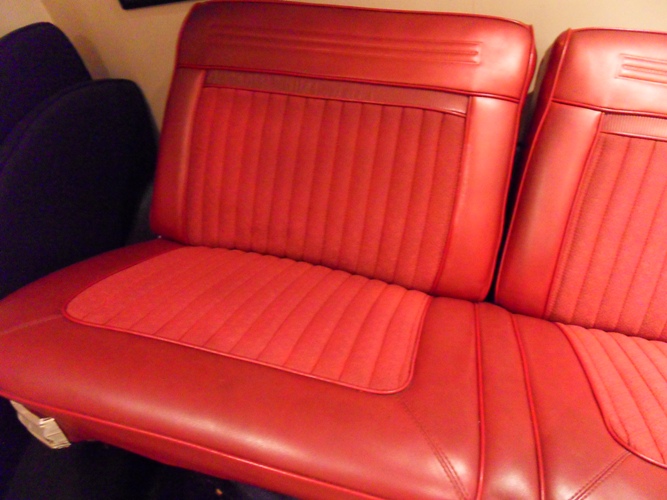

Posts: 7453

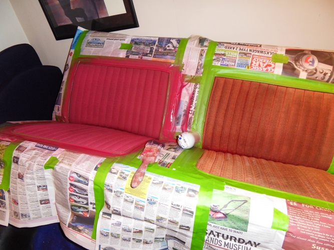

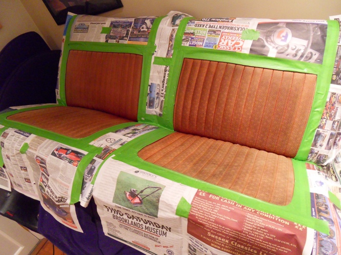

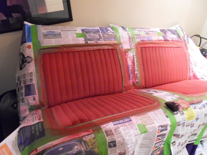

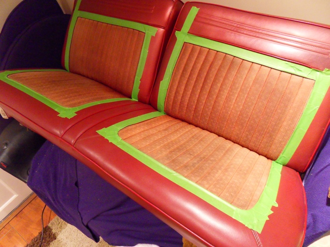

Went for it this evening...Mrs B out so I can use the back room to spray the inserts.....ok so far....see what its like when it dries [-o< [-o< [-o<
seats sprayed 3.JPG (181.8 KiB) Viewed 911 times

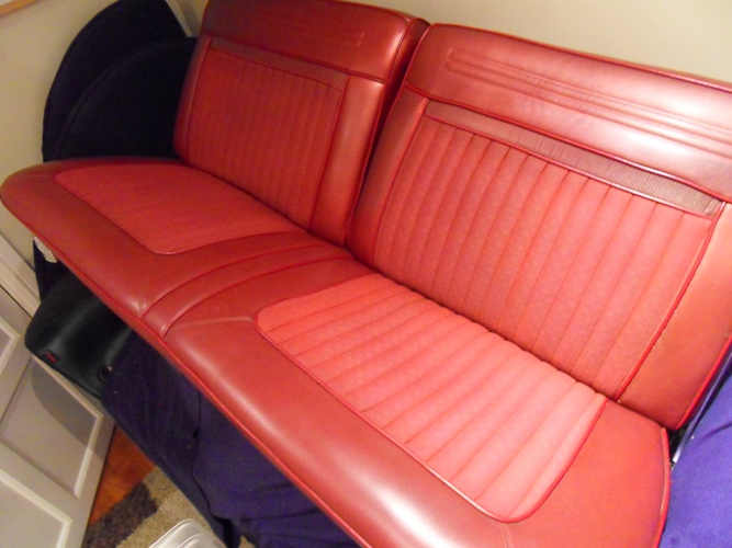

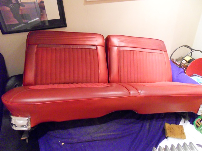

All done....just got to leave it to dry for 72 hrs. Pleased with the coverage and its easy to use. I sprayed it on and just worked it into the grain of the cloth with a paint brush to make sure it covered evenly. It is drying a bit darker than it looks on the pics which is more of a match for the original colour. Pays to mask carefully and wipe any overspray off before it dries.

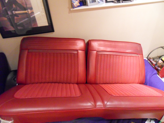

finished seat 4.JPG (151.83 KiB) Viewed 877 times
finished seat 3.JPG (155.91 KiB) Viewed 877 times
finished seat 2.JPG (160.03 KiB) Viewed 877 times
finished seat 1.JPG (141.73 KiB) Viewed 877 times

They look spot on Steve.
Result. Some pics after 72 hours please :thumbright:
