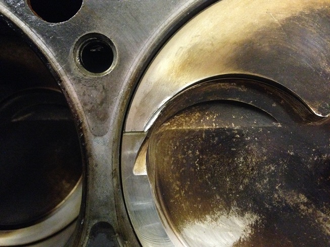

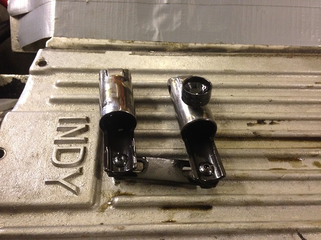

Went to refit my rockers after breaking one last Sunday, Dave Billideau kindly lent me one to get me back on the road, and noticed that the roller lifter below the broken rocker, seemed to have collapsed, so had to take the head off, anyway found the problem, the centre cup had popped out of the roller-lifter, and was sitting next to it? No damage at all! so popped it back in the lifter, then had a closer inspection on the pistons, I could see the inlet valves have been kissing the edge of the cut outs on the pistons, So did a petrol test on all the valves, and all but one was prefect, so just had to lap one valve in. So will have to take the other head off and with the dremel slightly relieve the edge of the valve cut out, When we built the motor I did a play-dough valve clearance test, and all was good?? So all in all if the cup hadn't came out I wouldn't have a clue about the pistons touching, So hopefully I can just get away with a set of head gaskets, I will pull the oil pan and check bearings and inspect the system one filter for debris, fingers crossed all is ok.

Sorry to see that Jim, might not be so bad once you stripped it down.
For what it worth, I always like to break the hard corner/edge of the valve relief area, to take away potential hot spots
Thats good advice Mark, especially if your using N20, no sharp edges!! :thumbright:

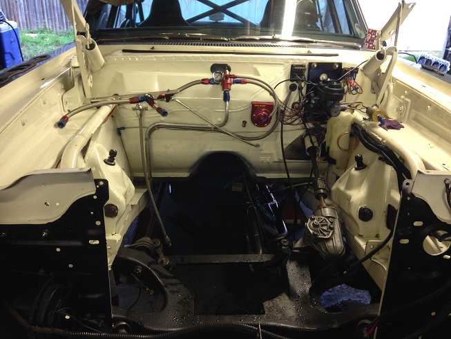

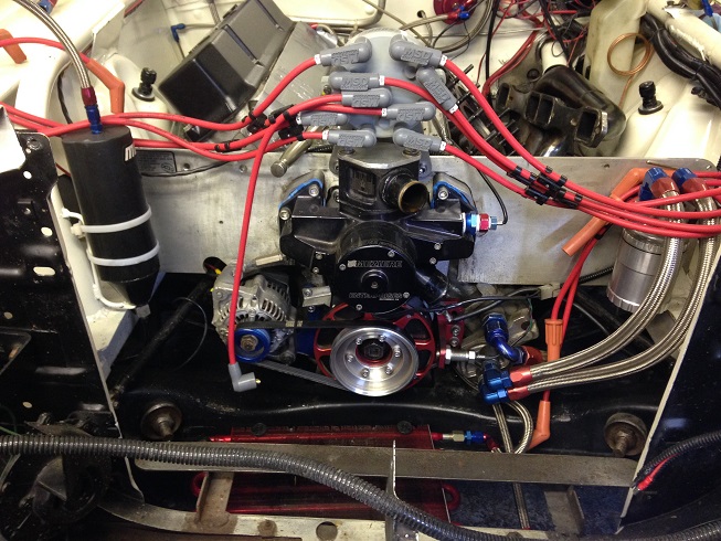

couple of pictures from today, front of motor without the rad in the way, and empty bay.

Posts: 22111
Have you got a revised Drag Link to clear the headers??
GTXJim
Posts: 1827
Location: cheam
Post by GTXJim »
Yes, home made, goes under the dragster style oil pan, that's why the K member has been modified also, took a bit of working out but works a treat. :thumbright:
Hell Yeah!! I'm a Redneck
Posts: 22111
GTXJim wrote:Yes, home made, goes under the dragster style oil pan, that's why the K member has been modified also, took a bit of working out but works a treat. :thumbright:
Fantastic - some close up pictures would be nice!! :thumbright: :thumbright: :thumbright:
