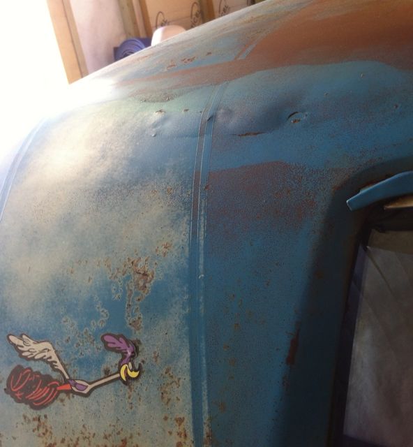

An odd one this! When I first got my car I noticed some raised bumps over the rear of the roof where the C pillar drops away. I assumed the worst (sound familiar :oops: ) and thought it was rust.
However, as i have no headliner I could easily see, touch and inspect the inside of the roof where it joins the C pillar/section.
The bumps can be clearly felt from the inside, but no rust, holes or anything obvious.
I thought i'd read that these cars used lead lining for this section of the roof and that over time it can shift somewhat..
Anyone know?
My concern is that I would like to know whats involved for rectifying it before I fit my headliner.
Posts: 7309
Location: Cornwall
Post by MilesnMiles »
pics show the ripples/bumps. Somewhat exaggerated by the light.
bumpy roof r.jpg (50.79 KiB) Viewed 860 times

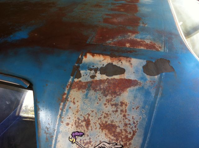

other side
bumpy roof l.jpg (48.32 KiB) Viewed 855 times
I would bet that the lead plumb has blown over time. The tinning agent reacts and eventually comes away...
I think Jem calls it "Patina".........
Posts: 13000
That's a better shot Miles, I agree with Pete, it looks like the original leading has blown...if you are leaving the original paint in situ, I would leave it as it is, but if I was repainting it, I'd dig the lead out and re-lead it or fill it with Evercoat Rage Gold...that would soon get rid of the patina!
latil
Posts: 12076
Post by latil »
I would guess at water ingress in the spot welded joint. Rust has formed,expanded but not shown as holes (yet). It would also lift the lead but not part it from the steel.
1965 Belvedere 2 426 Wedge.
Posts: 7309
Location: Cornwall
Thanks for the info chaps. Presumably to would need a half sensible body shop to sort that if I wanted to paint it.
Latil, could be rust based problem, but I really can push hard on the inside without anything looking to give way like you mitt expect. Hasn't changed in 18 months either;quite odd.
MilesnMiles wrote: ....... Hasn't changed in 18 months either;quite odd.
Well, its been 40+ years in the making ;)
Keep on with the Gibbs and forget about it. ;)
Mossy68 wrote:Keep on with the Gibbs and forget about it. ;)
:iagree:
Depends if you want to paint the whole car.....if not as above......Its just a Power bulge........ :D
latil wrote:I would guess at water ingress in the spot welded joint. Rust has formed,expanded but not shown as holes (yet). It would also lift the lead but not part it from the steel.
perfectly put, its just got pushed out from yrs of damp etc maybe never actually go i to holes in your ownership.
leave alone unless your painting it,
