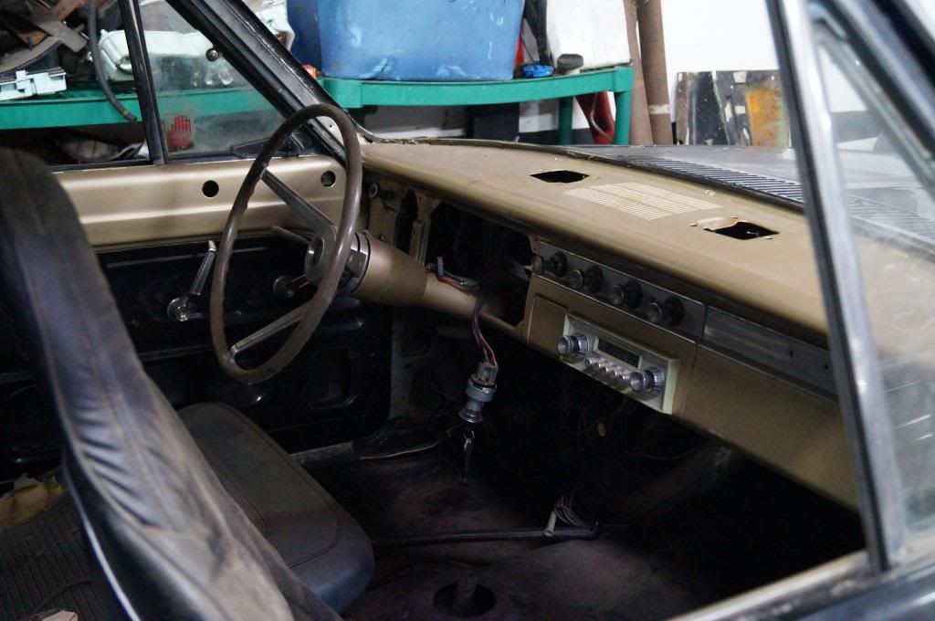

Story is that the previous owner bought it about 10 years ago from a policeman who’d got it from a banger racer who never raced it as he couldn’t get it started. No idea if that’s true, but what is known is that the last owner (name’s Clare, she’s got a couple of Yanks I think) had a 360 rebuilt and a lot of work on the brakes done at Tim’s Gasser Cave five or more years ago, then lost interest. It was originally blue, but has at one point had a reasonable repaint in black with a gold dash, (though now pickling up again and scuffed from sitting about).
So far I’ve found the floors will need doing, and the bottom of the rear quarters are rotting on a previous repair. Also the bulkhead has been cut away at the corners so will need two small patches.
Other than that, it’s really not a bad shell at all and I think the paint can be touched in to avoid a respray, at least if you want to get it good enough for racing, which is the plan.

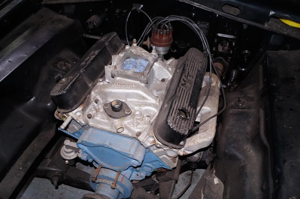

It has a 360 in it that I won't be able to use because of the pesky rules:

I'm buying Terry's 273 from him (when I can get up there to pick it up) which will get me on the road for MoT and I've got another '67 273 for rebuild into a race engine when time and money allow. A 318 would be far easier due to piston availability but I'm not sure they allow it, as the homologation was for GT racing rather than Touring.
