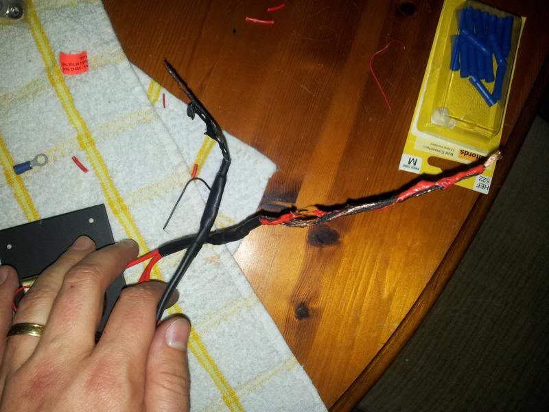

Looks like youv'e got it sussed mate, you only need a dash light feed to each of the thin reds to come on with the existing dash lights.Dave81 wrote:Steveo.........steveo wrote:how i'm looking at it , could well be wrong , & its my eyes or monitor or both!!, the red live (A) for the bulbs is connected to the gauge mounting brace one side , while the other side is used for the negative ( ground wire ) (B) unless in not seeing every thing , the whole lot is metal , soon as you connect it up , it blows a fuse as its like touching + & - together
just connect the three red lives for the bulbs together with a bullit or butt connector , don't have the reds bolted to the gauge mounted stud bracket / brace thingy , because that's grounded with the black wires ! or it looks it , from where I am sitting
now if the gauge mounting studs & mounting brace are individually insulated , ignore what ive just said![]()
That will deffo be the problem then.
Sorry no side views until later, but this is the issue I think....
All instructions are per this.....
http://www.carid.com/images/sunpro/cust ... ctions.pdf
The Voltmeter has rubber mounting boots between the gauge clamp and the terminals. Both Water temp and oil pressure do not. So by my working then at the very least both these are basically mated together through the clamp and blowing the fuse????
Also found the other instructions on line.......................What a muppet............![]()
I've gone and read the electrical gauge installation section and done that........![]()
So please confirm.............?
I do not require power feeds to the middle and right gauge as they are mechanical. I only need power and earth from the voltmeter.
The two posts on these are purely for mounting................?
Help is much appreciated chaps............
The thin black wires can connect to a good ground, as Dave999 says this wont work unless the cluster is metal and mounted to a grounded part of the car.
So all the larger wires can go except the two on the volt meter as you say they are insulated between the "U" clamp and the threaded studs. Is that also a thin reddish insulating sheet behind the clamp on the volt meter?
