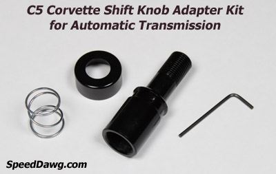

This is the part I needed to ream out to fit.
It is an adaptor that replaces the stock Corvette shifter handle with button and alows you to fit a 4-speed type ball that you press down to get out of park etc.

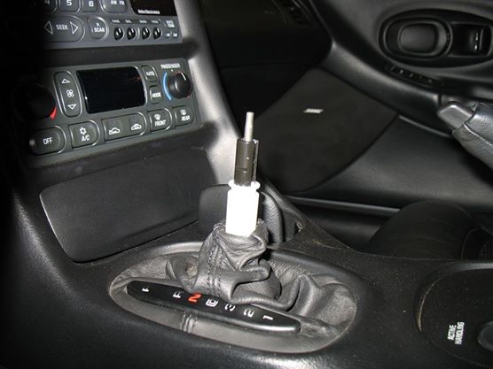

You take the stock knob and button off, pull it's skirt down, and this adaptor and spring has to slide over the hardend steel shaft (black bit) and nylon lower half (the white bit).
It was the black steel bit that was tight in the hole. It is something like 12.58mm diameter. So the 12.5mm would have been close and a bit of wriggling about might have done.
But a correct half inch size gives it just the right amoung of clearence so it preses down and springs back up.
Shame that like most aftermarket parts it does not fit as it comes. It is not as if it is a "Universal" fit. It is specifically for this year and model.

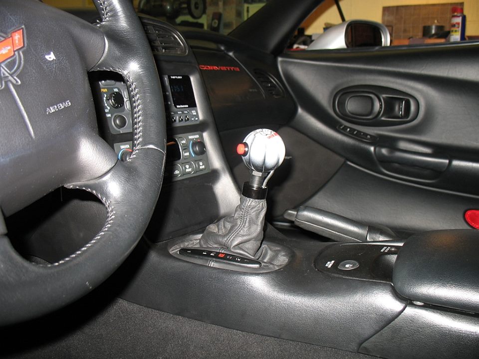

Once it was the right size then the actual "hard" bit was to work out how to get the cable from the line lock switch on the knob, down into the leather boot and around to the fuse box under the passenger side footwell.
I had to cut a bit out of the collar around the top of the leather boot and also grind a flat area on that adaptor to make space for the wire.
