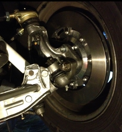

I went round this loop for ages (in a car that already had mopar factory discs) and in the end decided to go for all new.
First job was to get hold of drum spindles (which you wont have to do) and then I got the Wilwood kit. 4 pot calipers and 12" (corrected!) rotors. They were bigger than the originals anyway and helpfully stated 'fit under some 15" wheels :) ). Nah, diagrams are excellent - they help you measure with confidence.
Anyway, point is the kit was really good. Clear, complete, every nut, bolt, wheel bearing, mounting bracket etc etc you need. Literally follow the instructions and join the dots. Looks the business and most importantly DOES the business.
I sold my old rotors/calipers/spindles to a member on here - so a 'wanted' ad might bring a response if you had heart set on mopar originals...?
Failing that, Dave999s hilux hack is a really good bet - I just got the worries over finding myself with another set of calipers to rebuild and more pipes to make etc - so took the easy (but ££) option.
Basically, you pays yer money, you takes yer choice. But if you can stretch to it, the wilwood kit was a breeze really. American engineering and it fitted... amazing. :)
