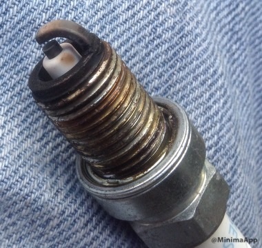

Chaps,
Any views on this plug by the 'expert plug readers' amongst you? Done about 1k miles. It's from a chewby small block. Seeing some pings at mid revs on mid to hard throttle., computer telling me it keeps falling on weak side of afr.
Thnx
Thnx

I can't see the picture you loaded ?
Here's a good guide
http://www.wallaceracing.com/plug-reading-lm.html
Here's a good guide
Great idea! Thanks Mark.
Now attached...
Now attached...
- image.jpg (66.66 KiB) Viewed 2355 times

Ade, no afr meter, just tracking blm etc on laptop off ecu. Mostly voodoo to me, but I believe blm count should be bout 128 for proper afr. This Bananarama! 140-155 (leaner) and ican see some knock counts coming up under pretty low load. From marks link it looks on rich side but with that brown patch on very white ceramic. Plug pic taken after vigorous but legal run at operating oil and water temp - not after a wot run unfortunately.
Just really trying to chase down the knock counts.

That plug shows it is too lean. The change in colour on the earth strap shows the timing is a little bit too advanced but if the mixture was richer it would probably be fine and the colour change move up slightly.
The brown area down the porcelain might be an indication of a rich spot occurring at some point but you need to sort out the idle and low part throttle mixture first.

That Don fella from FBO used to say it was an indication of timing advance.Mick wrote:I was under the impression that the ground strap was an indication of plug heat range, change of colour half way up the ground strap being optimal.
Yes it could be just that the plug is too hot for the engine combo. But it does look like it's lean to me.
Without any air/fuel ratio monitoring I would be looking at manifold pressure and seeing if vacuum increased with a richer mixture. Only if it doesn't would I then look at the heat range for the plug.
Thanks for feedback. I've got a few checks to go through like fuel pressure etc. let you know.
