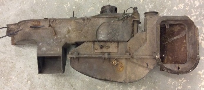

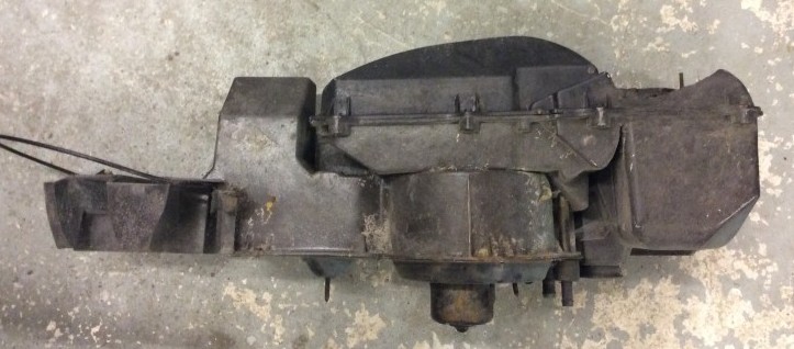

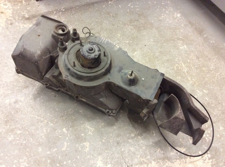

Can anyone out there identify this heater/air con unit?
I was told it was for my 69 Charger but I don't need it and I'm pretty sure it doesn't fit.
This was gifted to me a few years back, so happy to pass it on for free to anyone who wants it !! It's fairly rough but the motor and air con are still there
...otherwise, the scrap man will get it.
my bet is 70 71 72 73 74 E BODY

Defo not a 69 B body
Its not 72 A body either (so probably not 70's A in general)!
steveo
Posts: 3920
Location: Kent
Post by steveo »
good thinking on the 70 & later years :thumbright: has the 1/2 & 5/8 heater matrix pipes ,& not the 69 & earlier of two 5/8"s pipes
its a standard heater box for a 1971 -1974 B-Body / charger
