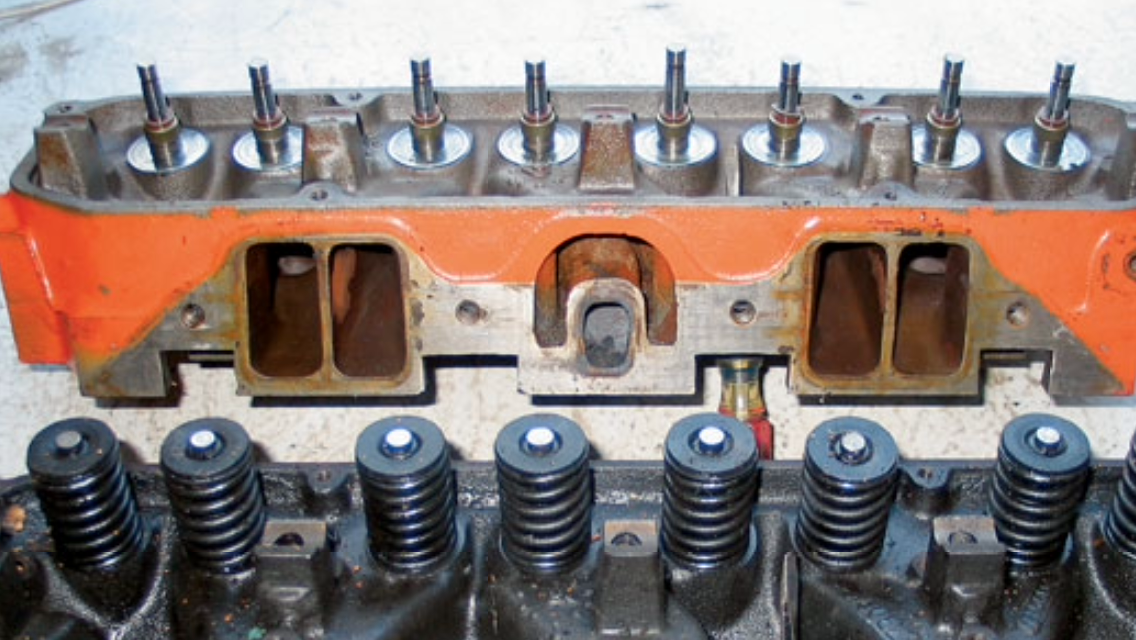

My heads seem to have a double cooling passage.
This I imagen is for a water cooled factory Mainfold
My Mainfold does not have this water cooling passage
So I assume I just block them off.
My gaskets only cover the bottom hole not the top.
See pictures below same as mine.
Also
The orange paint show where my gaskets sits and does not cover top hole
Ok ??????
<a href="http://s73.photobucket.com/user/autofet ... z.png.html" target="_blank"><img src="http://i73.photobucket.com/albums/i205/ ... 08efkz.png" border="0" alt=" photo 8E7B22AD-622F-4C5D-B5B8-37B8D39EA27A_zpshp08efkz.png"></a>
Posts: 22109
The "Central" area you can see is not for water - it is a heat riser for Auto Chokes, heated inlet manifold, etc.
Most Valley Pans now block that off - if yours does not have that then just Aluminium or Shim Steel and blank it off.
If you get water coming out of there, then you have a real problem

There's no need to block it off because your intake doesn't use it.
Posts: 22109
Fair point, either way it is not an issue...
